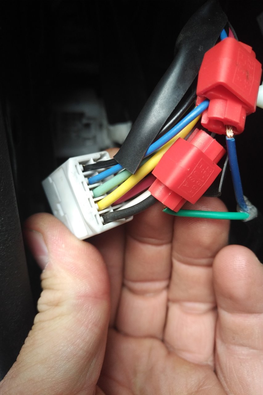

    You ended up doing the Blue to the Black and the Green to the Blue. I would have thought it would have been the other way around. Good to know. Maybe I’m not thinking straight this morning. Haha Drivers Side verses Passengers Side.
    Passenger Side
    Blue (Lock) to Red (Lock)
    Green (Unlock) to Green (Unlock)
    Drivers Side
    Blue (Lock) to Blue (Lock)
    Green (Unlock) to Black (Unlock)

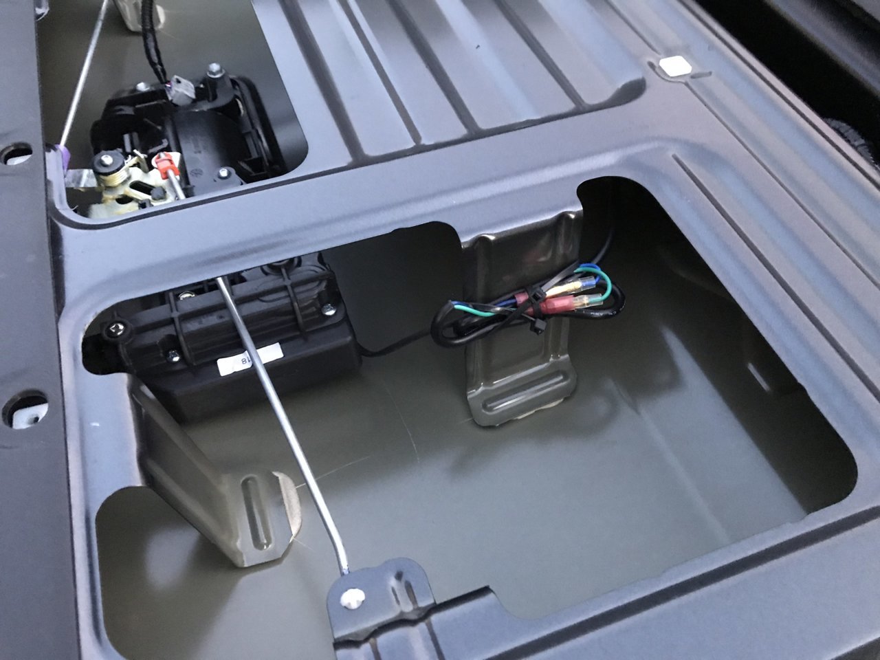

    Not me, that is what Gulf South Toyota installs as ‘factory installed’ (Port). Not sure if you can see in that pic, but the other is the connections for the ‘factory installed’ (Port) bed lights. Black wire goes to ground bolt to the left side of there.

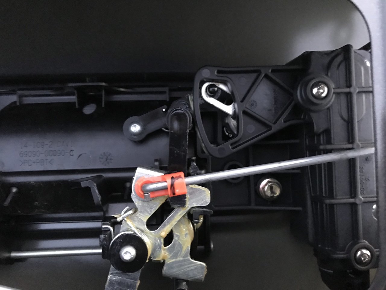

    Sorry, I may be confusing things - the first picture you quoted is the tailgate lock. The reply quote image was referencing the bed lights they also install. Even the tailgate unit is interesting...
    1765D827-8349-4A4A-9B10-5810C3F3A72B.jpg F67B1464-8C9D-4A2B-9E77-DC890EAD4AD3.jpg

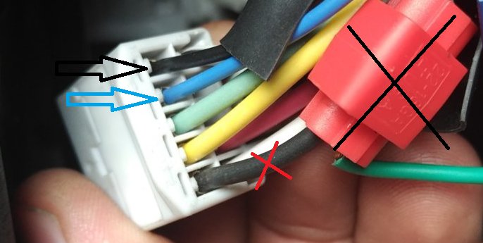

    I thought I would add my two cents. Just installed the Pop & Lock on my 2019 Tacoma, and KJTO had the correct wiring for Driver’s Side in my situation. I had to connect the blue to blue and the green to black in order for it to work properly. I used the same connector NoOne displayed in this thread.

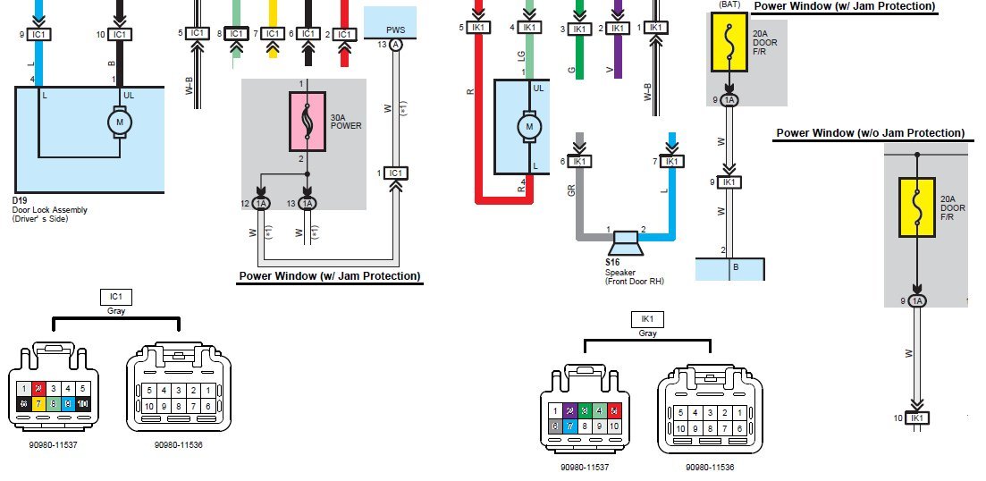

    In this diagram, the bottom left connector:
    Is it important to connect to the correct color, or to the correct pin position? My colors are mostly in different positions

    Show us a picture of the connector your tapping into, since you say none of the drawings match your vehicle.
    bigmw[QUOTED] likes this.

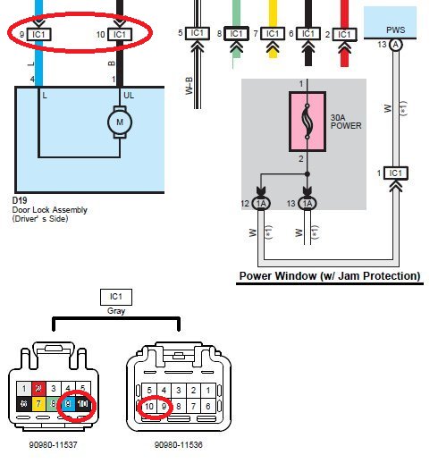

    Picture of my driver side connector:15638390408194894359078400803103.jpg

    L= Lock = BLUE #9
    UL = Unlock = BLACK #10
    strider51 and bigmw like this.

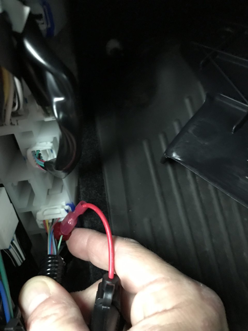

    Bunch of different mods
  17. Jul 22, 2019 at 6:15 PM
    #37
    caribe makaira
    caribe makaira Well-Known Member
    Feb 13, 2011
    #51121
    11,786
    Caribbean, Puerto Rico
    05 PreRunner TRD Offroad AutoTrans
    Hood Struts, My version Fogs always ON, Map & Overhead Light Mod,
  18. Jul 22, 2019 at 6:16 PM
    #38
    bigmw
    bigmw Not-So-Well-Known Member
    Feb 10, 2016
    #177702
    654
    Northeastern Ontario
    2016 Blue DCSB Sport 4x4, manual transmission
    Yeah, I figured that out too late too. That will be taken care of when something actually fails in there.
    Thanks!

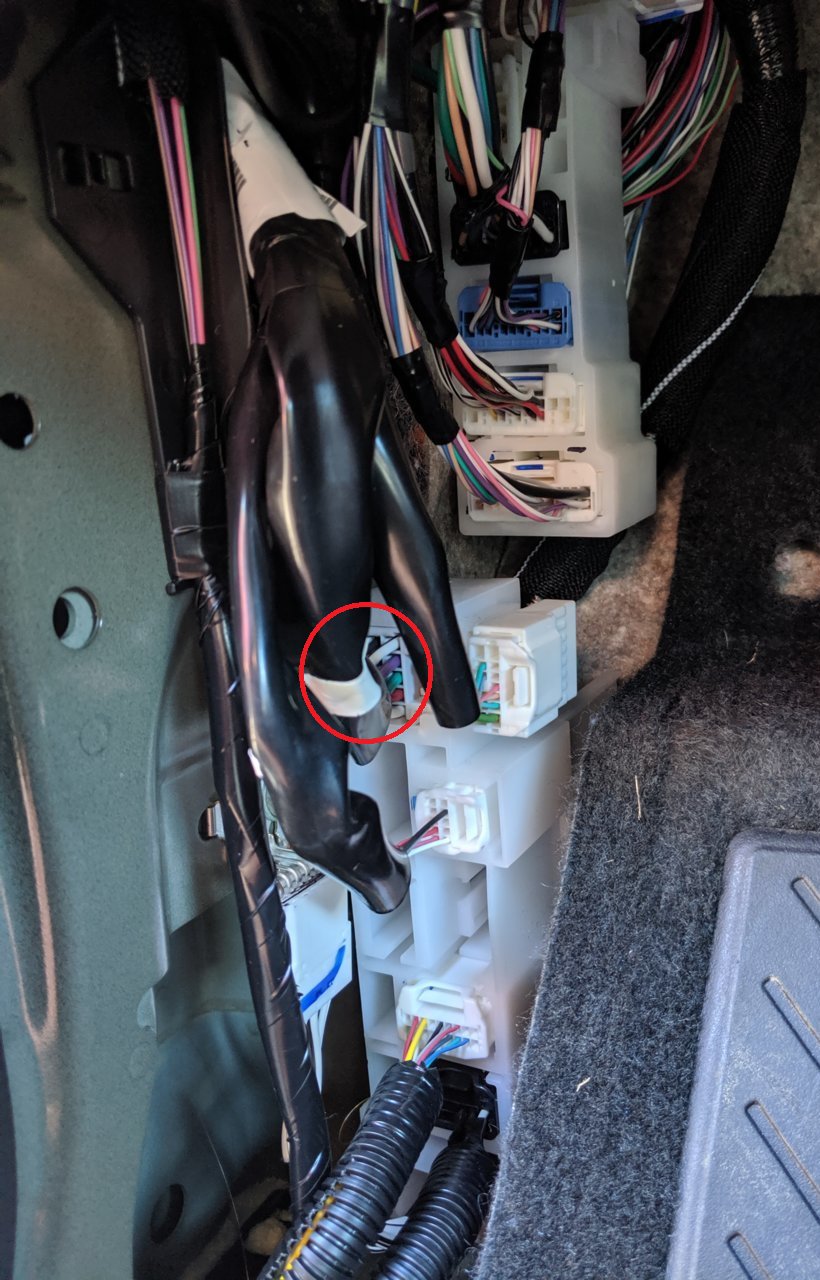

    Can you possibly post a pic of where that connector is when it’s plugged in? I’m going off the directions and it’s having me plug in right behind the ECU. Really hard to get to.
  20. Feb 18, 2020 at 4:31 PM
    #40
    caribe makaira
    Feb 13, 2011
    #51121
    11,786
    bigmw likes this.
