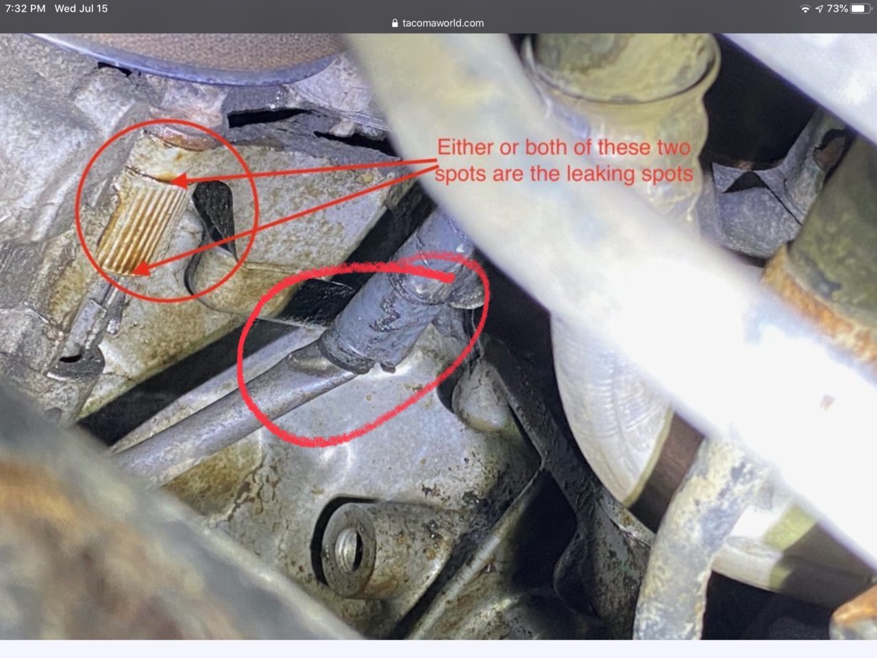

    I posted here just a couple of days ago about a potential timing cover leak. Today, I took the skid plate off and looked from underneath. And seem to find the main leaking point:
    This is taken from underneath looking up. It seems that where I pointed with arrows are the leaking spots. Do experts agree? The problem is that it is right behind the fan, so the fan has blown the liquid everywhere, as shown clearly in the picture.
    The most important question is: is this a bad power steering pump (based on youtube videos, it seems to be easy to replace it myself) or the dread timing cover leak?

    Is this a kinked harness or bent fluid or power steering line?

    It is a electrical wire going to the power steering pump.

    Looks like timing cover to me. You can try the UV dye to be sure, but thats a notorious timing cover giveaway.

    Looks like it's dropping on to that shaft and spining being flung around splattering it all over.
    Timing cover by the dark brown oil.
    Ps fluid is more clearish.

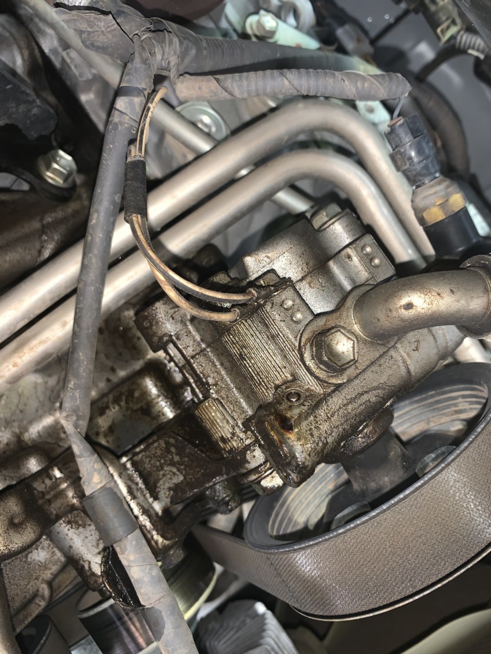

    In fact, I just checked my truck, since I cleaned it very well yesterday (and went on a one hour run). It is quite clear that the leak is coming from above (and behind) the power steering pump. So I believe it is timing cover leak. :<
