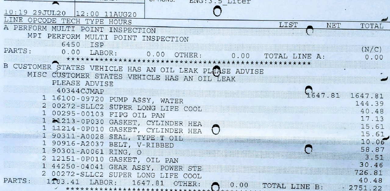

  3. Jul 29, 2020 at 12:51 PM
    #23
    harbrown
    harbrown Well-Known Member
    Aug 3, 2016
    #193686
    118
    Harold
    Daphne AL
    2016 Tacoma Off Road 4x4
    Hey guys, i will jump in on this one. A few months ago doing an oil change i noticed the same leak as on this post. I hit it with some de-greaser and moved on since i didn't know what it was, i noticed it had not dripped onto the skid plate and was basically a small seep. this morning i started to change the oil, noticed it again, knowing the timing chain cover issue, i figured that was it. Brought it to the dealer at 10am this morning, and that was the diagnosis.
    As someone said earlier in the post, and i have seen other post , and quite frankly experienced myself - the leak is a seep and doesn't appear to be that big of a deal. I drove for sure 40k miles and the leak did not get any worse. The dealer actually said seep not leak.
    Lucky for me, i got the extended warranty so it will be covered. Of course the dealership recommends water pump and serpentine belt while they are doing it with no charge on the labor. $200 for the parts, truck has 90k miles so I am doing it.
    Got a chance to talk to the tech, they have to pull the engine for sure. its on the books as a 22hr job. I told him i had just got my spark plugs in and was going to tackle that soon, he said he would throw them in while he has it out. Tech admitted the leak/seep is common on 16 and 17, said it was not a big deal and many don't even know its a problem.
    bottom line, if i did not have the warranty, i would not get it fixed.
    Dropping it off Monday 7am where they will start on it, good luck to me.

    Follow up to my previous post ... the extended warranty covered it, while they were working on it they found the rack n pinion had a leak, said the ext warranty covered it so i had no out of pocket. took 8 days to complete due to having to order the rack/pin. Overall so far I guess we are good. The tech installed my spark plugs that i had just purchased. I would suggest giving the truck a serious look-over at 55k miles. I am sure mine was leaking but i did nothing about it. $1100 for parts ($726 for rack/pinion) and $1600 for labor.

    oh wow, i havent had those issues. BTW, i posted my bill, 1600 for labor and $100 for gasket parts. what was your estimate. are you saying your estimate was $4k and Toyota paying half $2k ?

    thats pretty crappy. not sure if my estimate was better price due to ext warranty covering or if that is my dealers rate. My leak was very small and will not fix it again out of my own pocket. i will drive this truck 300k miles so the leak will just have to be.. mine leaked for a year before i did anything, never dropped on the driveway, just a small weep on the front of the engine. as someone said, it anti rust lube. good luck with the dealer.
