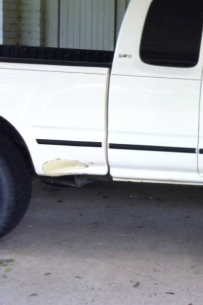

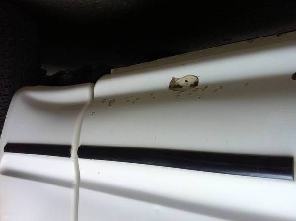

    Hey guys, as the title would indicate, I'm getting ready to monstaline my rocker panels on my truck. The reason I'm doing it is because there are some HUGE paint chips and spots missing from the PO.. I'm assuming from driving on gravel..
    Passenger's side (sorry for bad quality):
    Driver's side:
    As you can see there are some pretty rough spots in it that look to be all the way down to the primer.
    Normally when you apply this bed liner to the rocker panels, you sand it down a little but not all the way down past the paint. So I'm wondering how I'm gonna do that with paint missing. I could, but I would still have the chips that are down to the primer and all the rest sanded correctly. Then I would be worried about it chipping again. I just want to know how to prep this surface for the bed liner. Is there anything I can do to even it up so to speak? Does that make sense?
    Any help would be appreciated. Thanks in advance.

    most of the bed liners ive ever sprayed said to sand the surface and any bare spots with rust etc to clean till its shiny and then spray with an epoxy primer...then spray your bed liner according to the tech sheet.

    Prep the bottom with whatever grit of sandpaper the instructions say. You can smooth out the missing areas by putting the sandpaper on a little rubber block and sanding in a "crosshatch" pattern: sand in an X. Longer strokes will smooth it out more evenly. If you want, you can go a couple of grits courser to begin with, just make sure to stage it up afterward. 180 grit is probably the coursest you should ever need to go, unless the instructions say otherwise. Go to your local jobber and buy an aerosol of self etching primer to spray the bare metal areas that you have now created, following the instructions on the can exactly as far as flash off/ drying time go.

    Thanks so much. Exactly the kind of reply I was looking for. The product is Monstaliner which is roll on, if you were wondering. And thanks for the tip about the top edge, that will help alot. So basically you're saying to sand it as far down as I need to to make it even with the chips, and then hit it with some self etching primer? Sorry I'm just trying to get perfectly clear on this before I go sanding the paint off my truck haha

    Yes, that's exactly right. No need to sand all the paint off if there's nothing wrong with it. It's just bodywork- you can always fix it if you don't get it right the first time!
