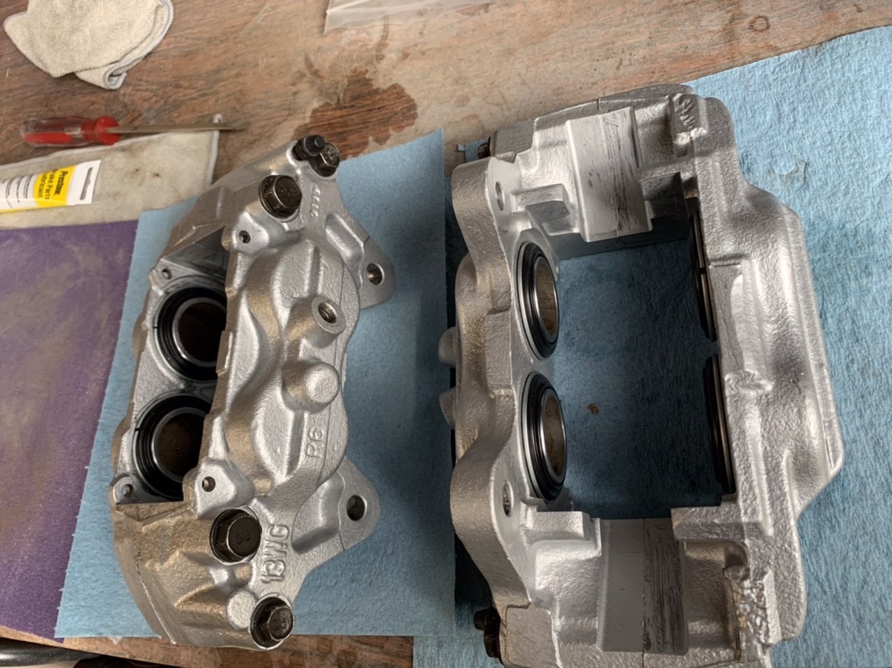

    Ok here is my story and I am hoping somebody has an answer for me. I had my brakes fail due to my flexible brake line rubbing against the frame and wearing a hole in the flexible line. i Replaced the flexible lines on both sides and decided since I was getting close to needing to replace my pads that I would just rebuild my calipers and repaint them while I was working on them. because one of the bleeder screws broke off in the caliper.
    So I removed the calipers, pulled them apart, sanded them down and repainted the calipers and had the rotors resurfaced while I was waiting on my caliper rebuild kit to arrive. Got my rebuild kit finally and when I went to replace the O'ring that seals the brake fluid channel between the 2 pieces of the caliper I noticed there was no replacement Oring in the rebuild kit for that.
    IU could not find a part number for it anywhere so I called the dealer. He looked it up and told me that toyota does not stock that Oring and it is unavailable because they do not recommend separating the halves of the caliper due to potential resealing problems.
    The damn thing is not available. He even emailed me the schematic of the caliper with the notation on the schematic stating as such.
    unfortunately I removed everything from the calipers and discarded the old Orings before the parts kit arrived as it never crossed my mind that a replacement would not be included in the kit.
    You will see on the attached file that the notation on the lower left of the picture confirms this. So I do not know what to do now. Any help would be appreciated at this point with my truck on jackstands and out of commission in the driveway!!!
    Just an FYI the original Oring is square cut (flat) and not a normal type Oring

    Hardware places sell O rings.
    caliper separation is not recommended. Rebuilt kit involves replacing the piston seals and dust boots.

    an aftermarket seal kit may have that o ring.
    or you can try putting the caliper back together, re use it, and see what happens.
    wouldn’t be a bad idea to apply some seal grease to it.

    What the heck!? No, that’s a terrible idea. It will leak without that o-ring, and then he’d have to start all over new. I rebuilt my calipers last year and also separated the halves to properly clean and paint. Pretty sure my rebuild kit came with o-rings or maybe I got away with re-using the old ones… no leaks either way.
    OP, look up the oring store online. Just need measurements.9279F31B-13B6-4D55-A4D9-04F52701B4FF.jpg

    re-use
    honestly, those bolts don't look microserrated
    typically it's Germans and their partners doing crazy such things
    doesn't look like a Cracked-style mating interface either. Which, if it was, it would still match.
    Question is what condition is the old seal in. It's been exposed to years of heat and hydroscopic DOT4.

    Thanks. But that was after painting. Worst part was wire wheeling and cleaning beforehand. Pure elbow grease. Yeah, no road salt here on the Olympic Peninsula, but we got salty air :)
    OP says he tossed the old seals. Your statement which I initially quoted suggested to just put them back together without and see what happens. I just wanted to relieve the suspense; leaks! That’s what would have happened.
    And technically it’s DOT3, at least from the factory, but DOT4 would work just as well, as long as it’s not DOT5.
    I’m not worried about the calipers separating. I used some loctite left over from gun barrels (620 I think?) so it can take the heat. Dykem on the heads for extra insurance, so I’d notice right away every time I look under there.
