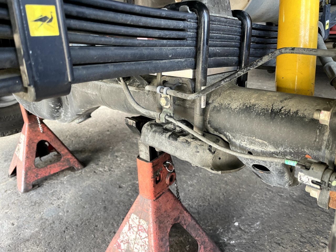

    Hey, did you resovle the vibration issues?? Does the shim works?

    I am currently experiencing this. After I lifted the front with OME, no shake (just poor alignment). After I installed Dakars, then really terrible shake from 5-25mph but perfect alignment numbers and wheel/tire balance

    Check your pinion angle

    And carrier bearing if you haven’t already. Easy enough to overlook.

    The 3 degree axle shim worked excellent for me. No more vibration.
