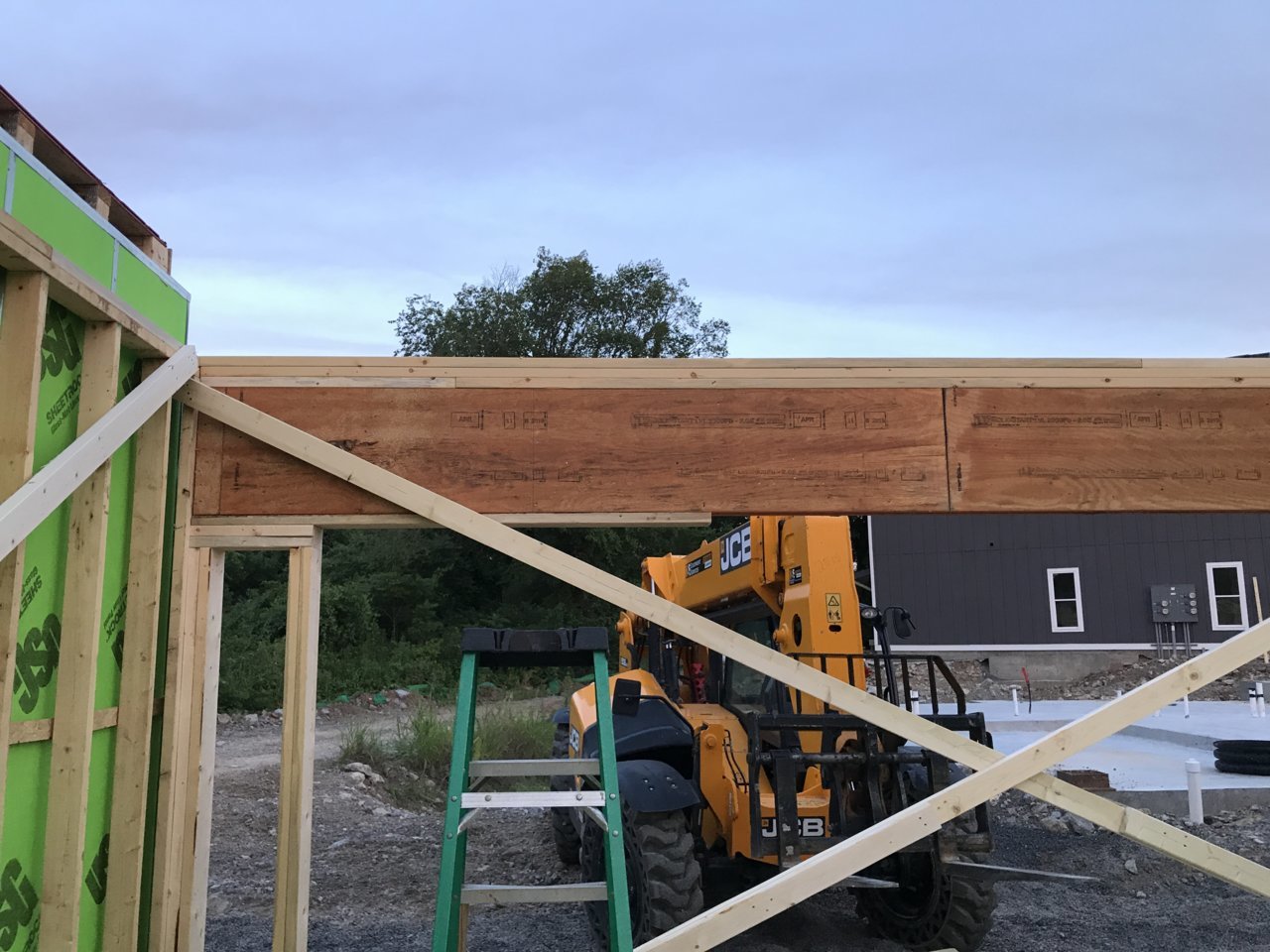

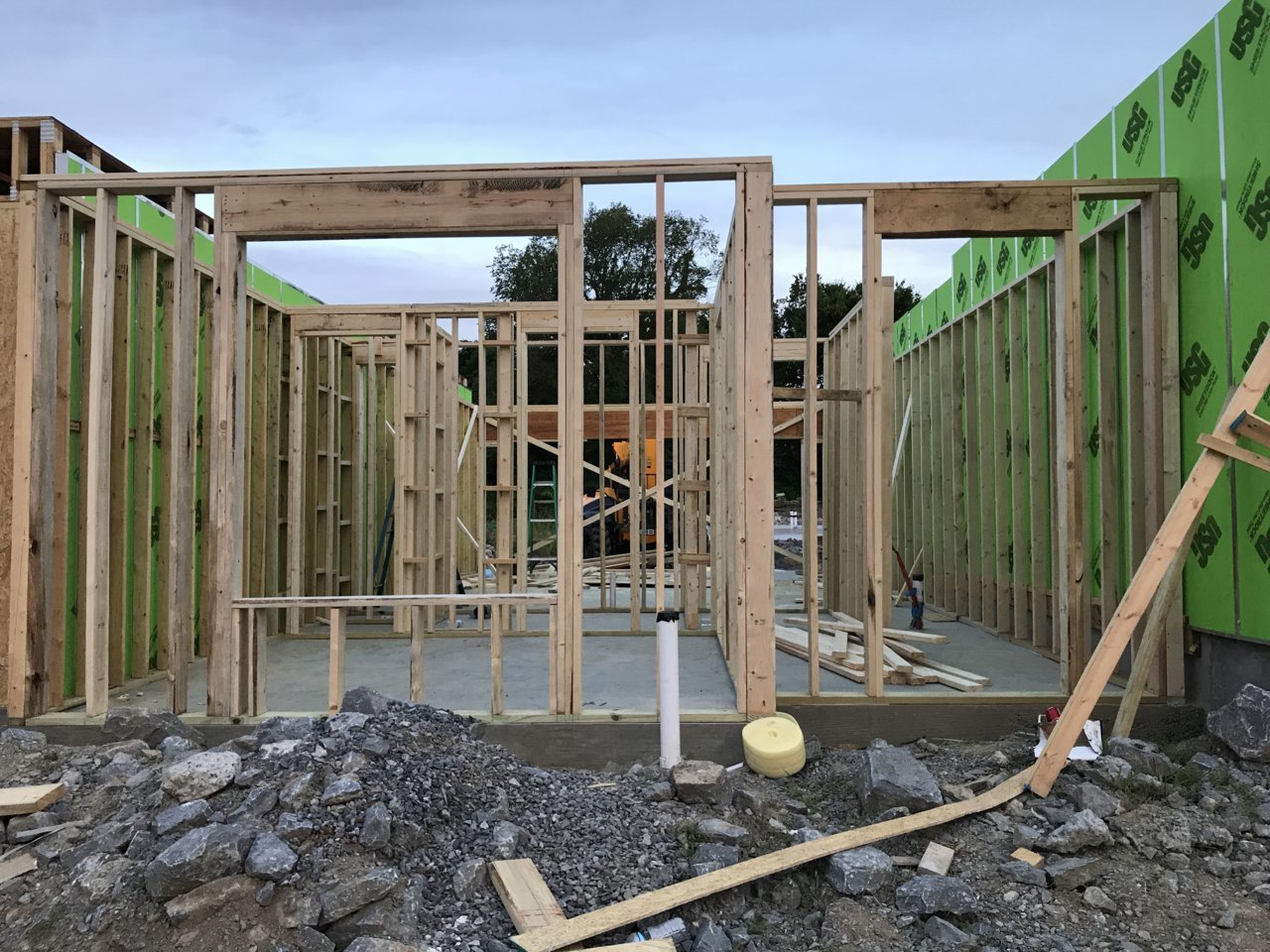

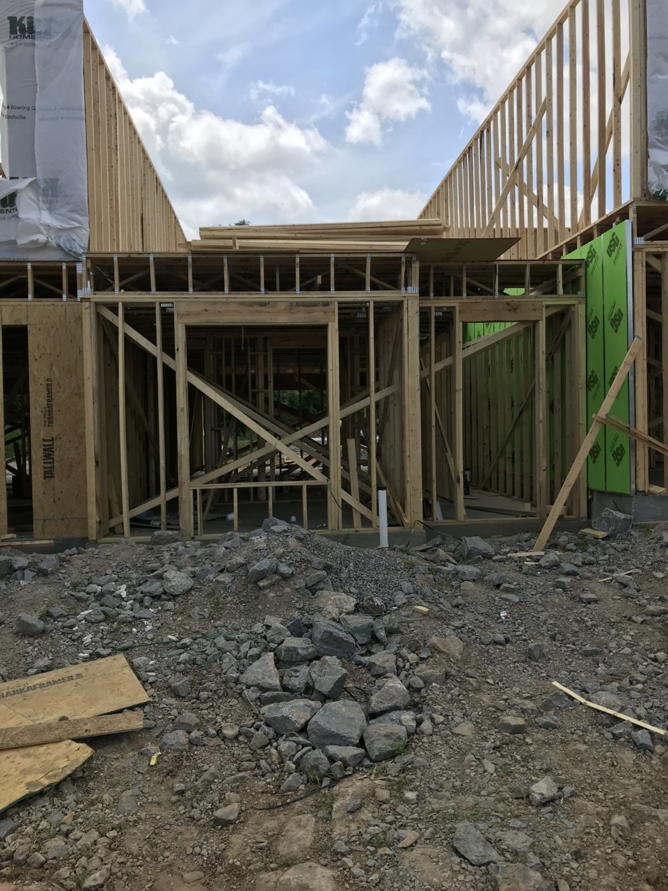

    Hey guys, they finally started framing.

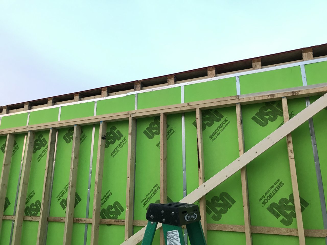

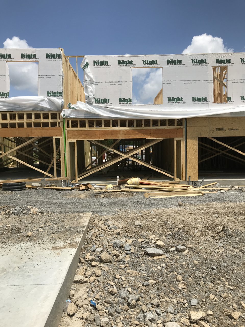

    Coming along quickly with framing

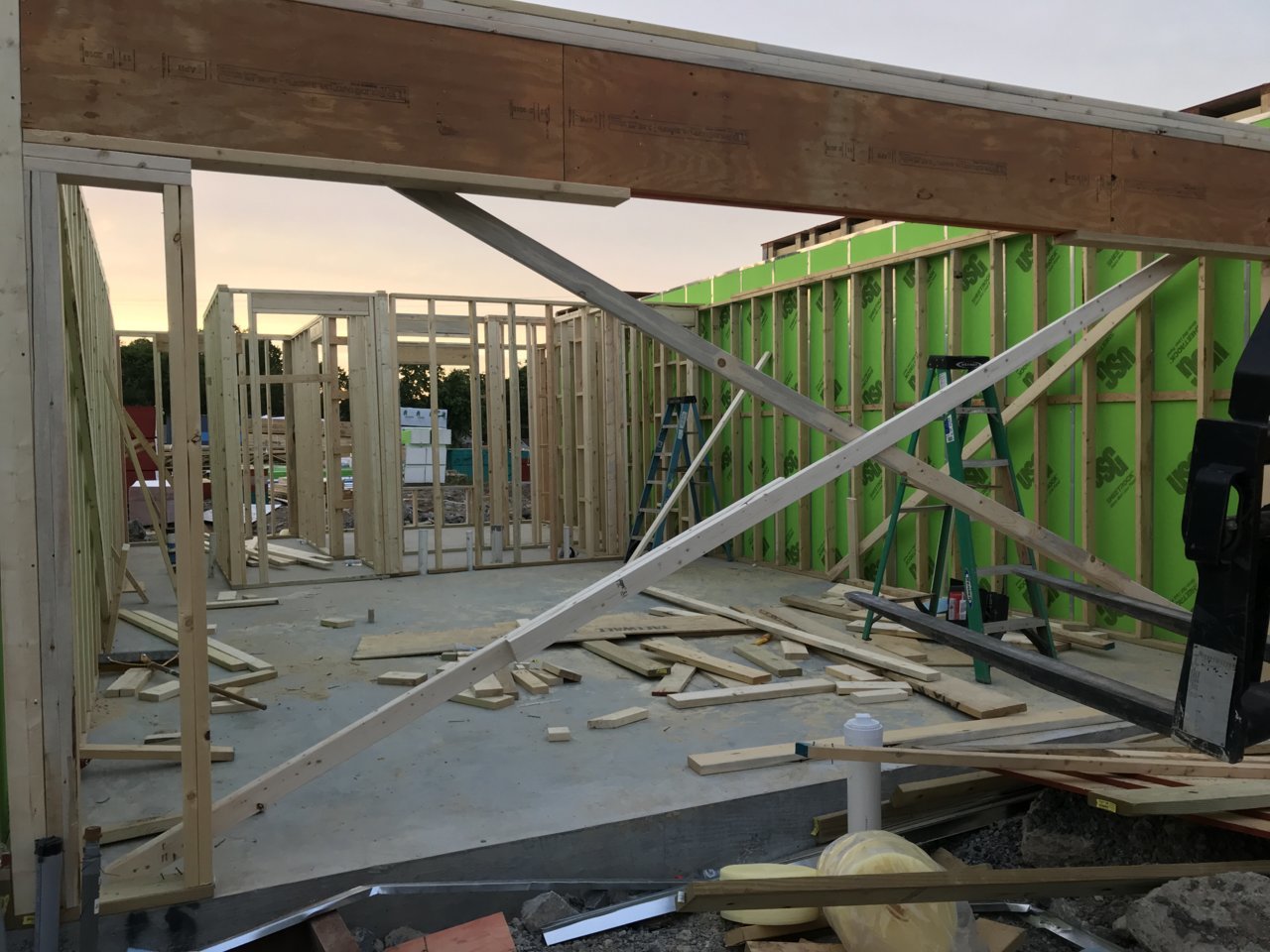

    Whats the deal with what looks like truss nailing plates on the short stud to plate connections above the window in pic 2 ?

    Can you circle what you mean? I can go back and take better pics.

    The silver hardware connectors top and bottom of the short studs above the window in pic 2

    I'll try to scoot by there and take a look. They probably already put vapor barrier over it though
