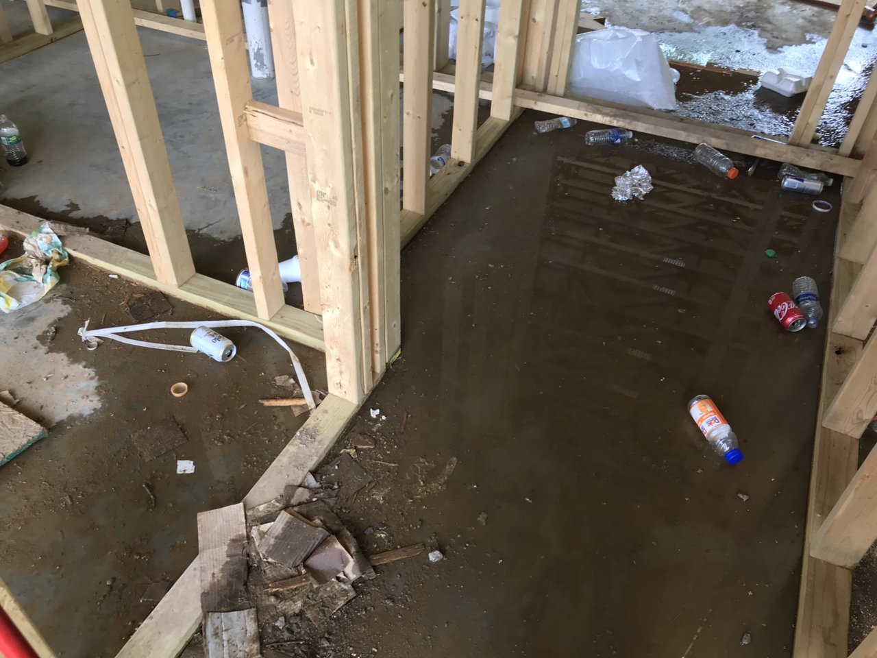

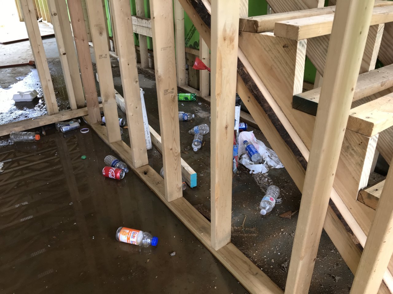

    Pretty fucking pissed off right now.
    I filled up four 13 gallon trash bags with TRASH today. Beer cans, water bottles, FOOD ITEMS (some of which had grown MAGGOTS), etc. I am very close to sending a very long email about how disappointed I am in the state of my first home. It is getting treated like a TRASH CAN and a BATHROOM. Yes, I smelled human urine in a spot on the second floor.
    The pictures you see here are merely scratching the surface of how disgusting this place is. I haven't seen this many flies buzzing around since I visited a GOAT FARM IN RURAL CUBA.

    Holy shit I'd be irate, sadly this is the standard most people live up to nowadays... Seems few and far between finding someone who treats the work they do as if it was their own.

    The GC should be on top of this. Evidently not. He should realize other people are looking at it, and wondering if the workmanship is also sloppy. I wonder how many prospective buyers just moved on.

    If a GC allows a site to look like that, they have zero pride in their work.
    That’s disgusting and unacceptable in my book.
    With regards to the water, it can cause unseen issues like glue separation, fasteners to weaken and possibly mold.
    It’s your house, screw having someone else have the conversation with the project manager....do it yourself.

    Looking at OPs picture I don't see pressure-treated 2x4s on the foundation pieces.

    Depending on local code , pressure treated plates may not be required . Here pressure treated is only required if the plate is in direct contact with the concrete , standard lumber can and almost always is used with a sill gasket or similar membrane that eliminates direct contact between the lumber and plate .
