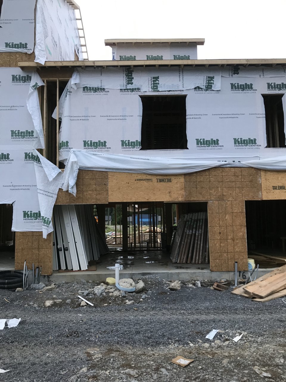

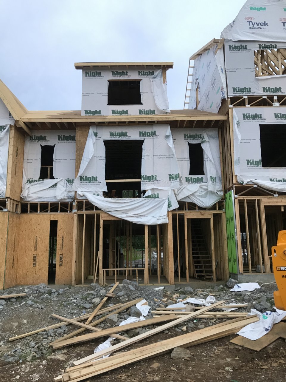

    Current state. Posting more notes in next post

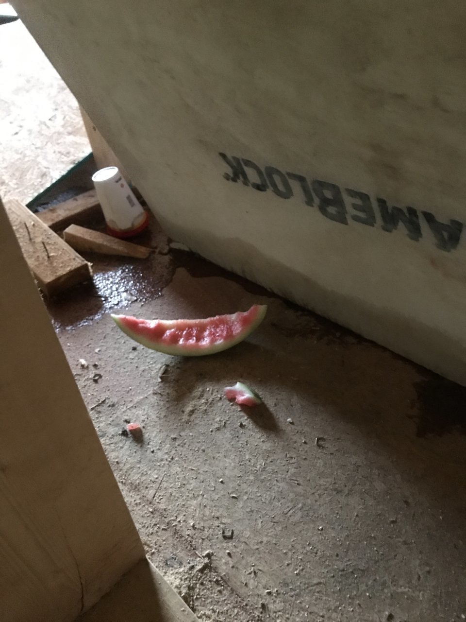

    Finally decided to walk up the sketch 2x4 ladder to the third floor. Filled up another 13 gallon trash bag. TONS of OSB roofing in master bedroom. Had to move a lot out of the way to see if anything was underneath (often times there was).
    Freshly eaten watermelon and a spilled red drank, or coffee or whatever. Yummy. I'm sure that's great for OSB.

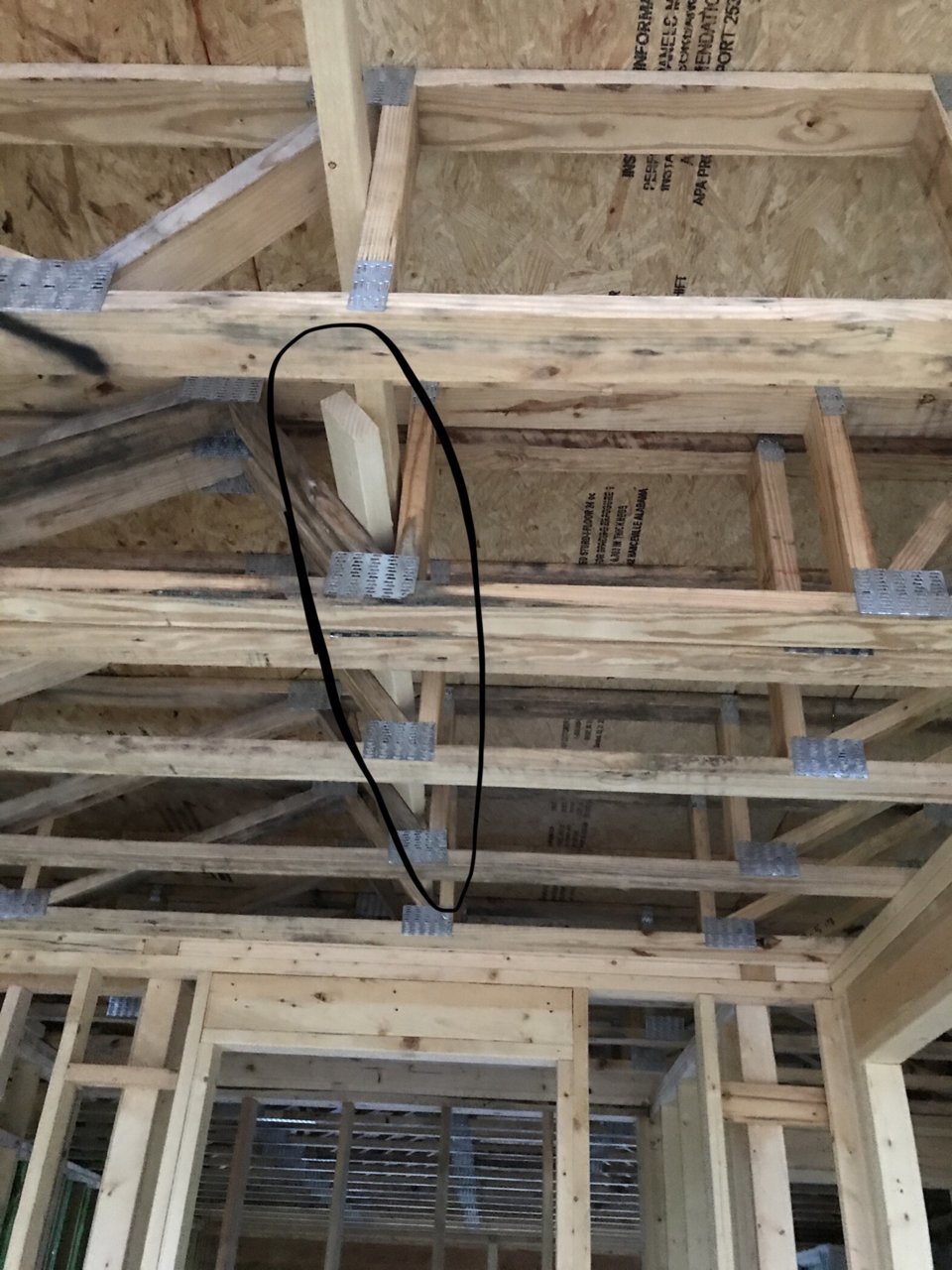

    I put some HVAC changes in my change order.. wondering if it will be easy enough to make more square cavities in an already built floor truss?
    I just noticed.. what the hell is going on with that angled 2x4??

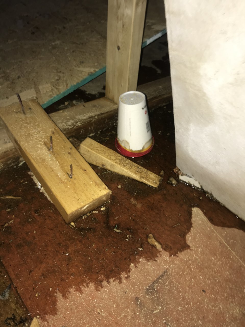

    Floor right here has two different types of OSB. Not sure what the reddish color type is. It seems like it's not level. Not sure if it'll be straightened out later?

    2x4 just looks to be web strapping , like with roof trusses

    Edges look like they have swollen on red piece

    No doubt that they have with all of the rain! Is that fixable or would it require new OSB?

    Will it be difficult to make more square cutouts for addtl return ducting?
    So this part is normal?
    Looks kinda out of place. no idea though.

    Somebody has nailed that 2x4 to the chords of the truss joists to keep them on their centres during framing , pretty normal stuff
