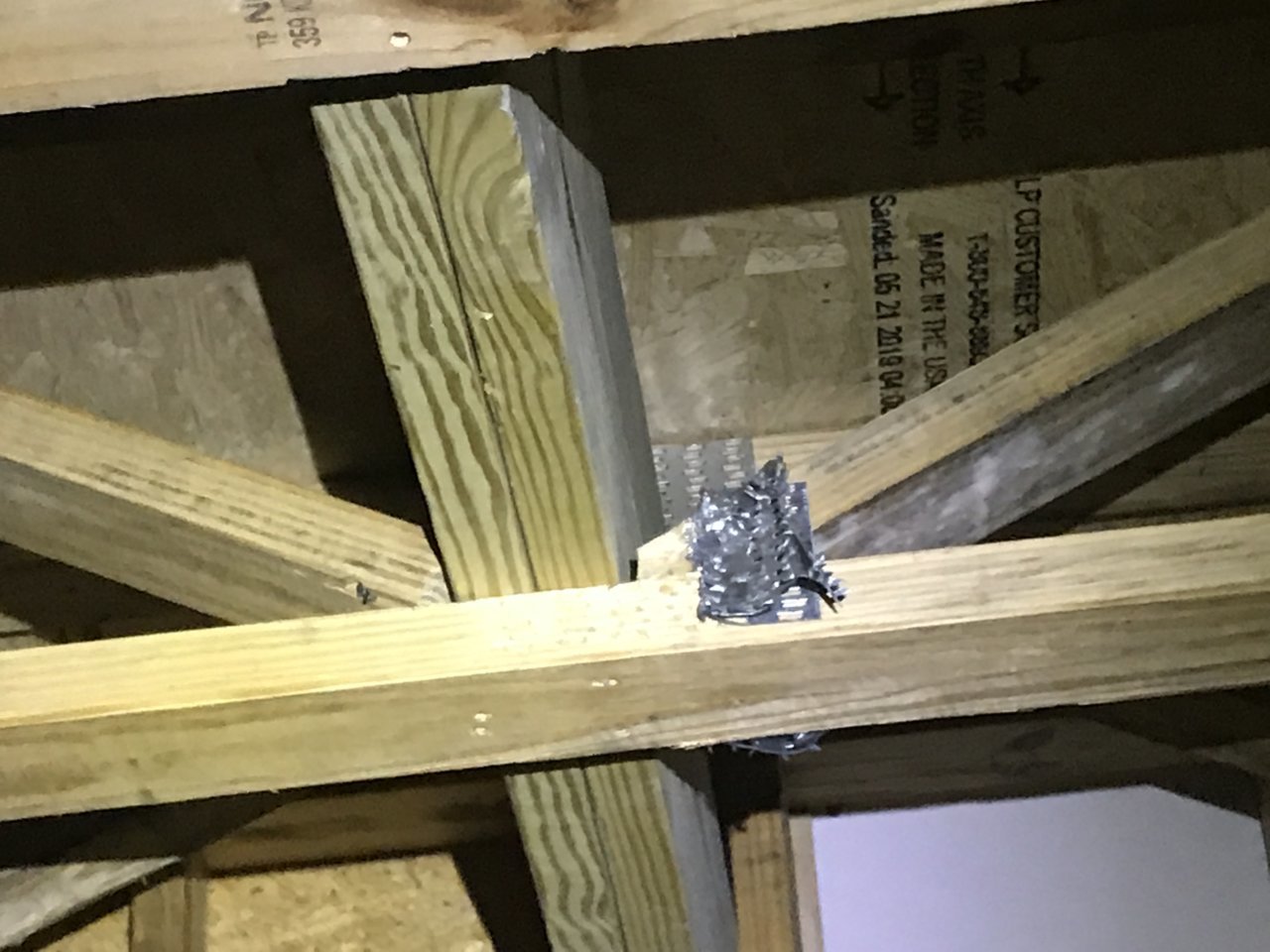

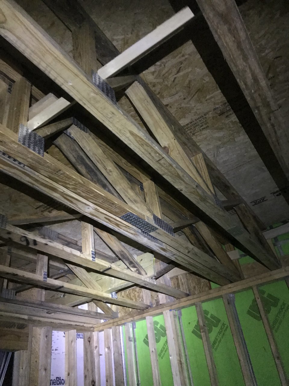

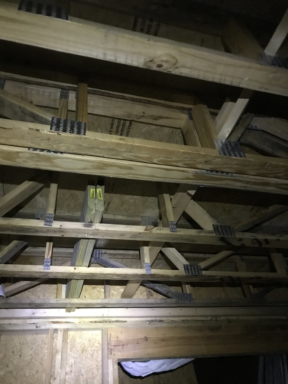

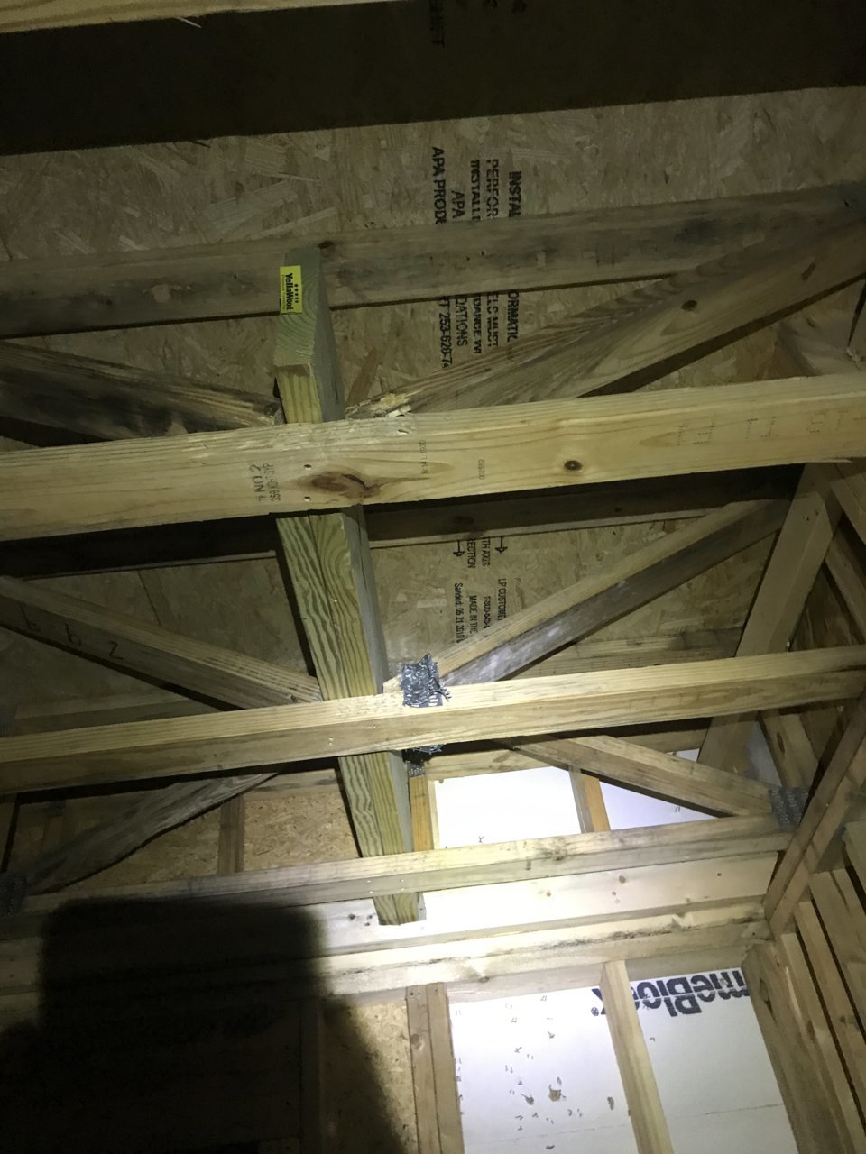

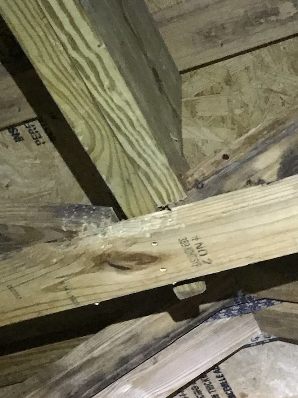

    I went by there yesterday and noticed that some of the floor trusses have been modified. I am not sure why, but it looks to me like they are in fact making changes to the trusses. Sorry I didn't get any pics, it was dark out when I went by there.

    tomwil
    tomwil Well-Known Member
    May 15, 2014
    #129887
    8,025
    East Coast USA
    2014 Reg Cab 4x4
    Pics would help, but maybe next time bring a camera with flash?

    I'll go by there this afternoon and get some pics! Since I took one of the same area last week, I'll post them in order to show the differences.

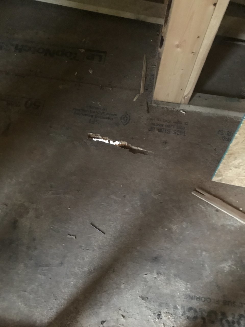

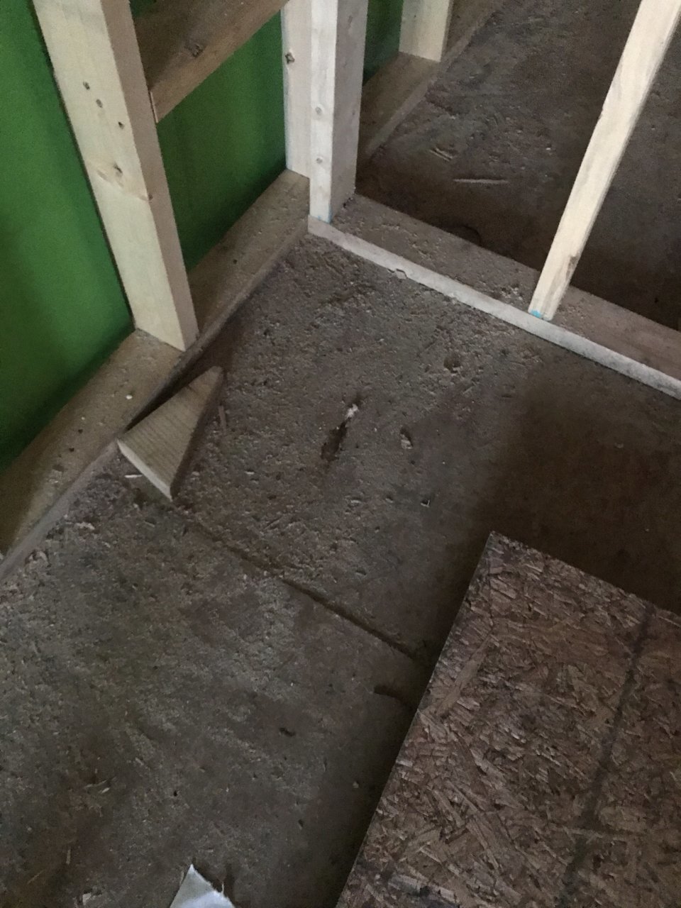

    How the heck do they manage to do this? Looks like a 2x4 or OSB was dropped onto these spots pretty hard

    Still kind of waiting to see these truss modifications, and why they were done.
    Does seem like they are hacking their way in building this home.

    Yeah, I totally forgot to get pics and remembered as I was just far enough away to not want to turn around haha. I'll check it out tonight if I can.

    Corner of a sheet of plywood falling from 8' would do that to OSB subfloor no problem

    British Columbia
    I'm going to go out on a limb here and say thats not something designed or approved by the truss engineer
