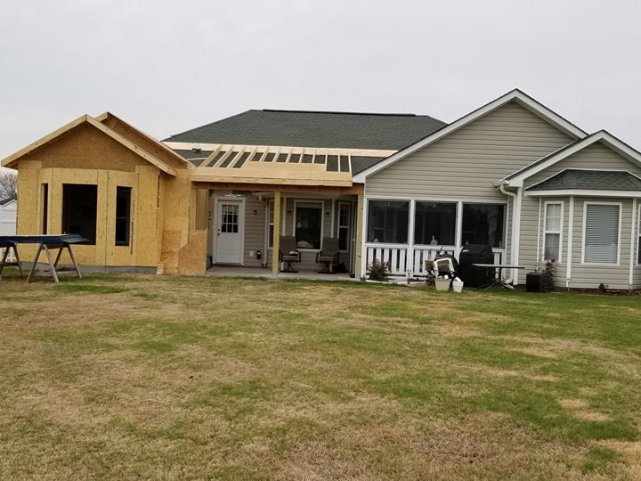

    For comparison, My builder did this addition last year. 14x14 room and open-air porch for $20K Notice NO garbage, They cleand up very well every day.

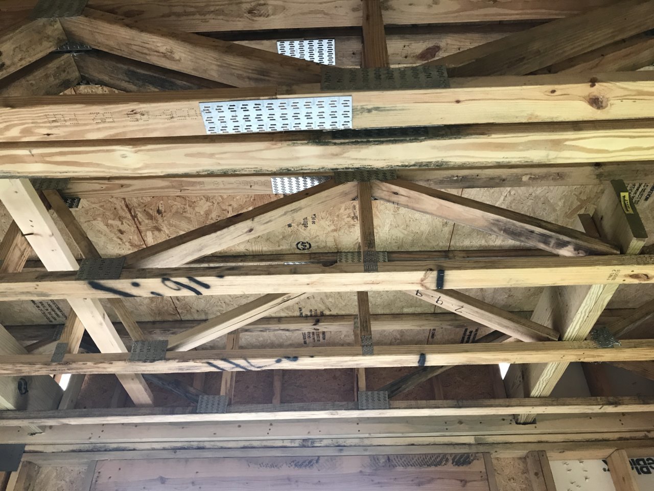

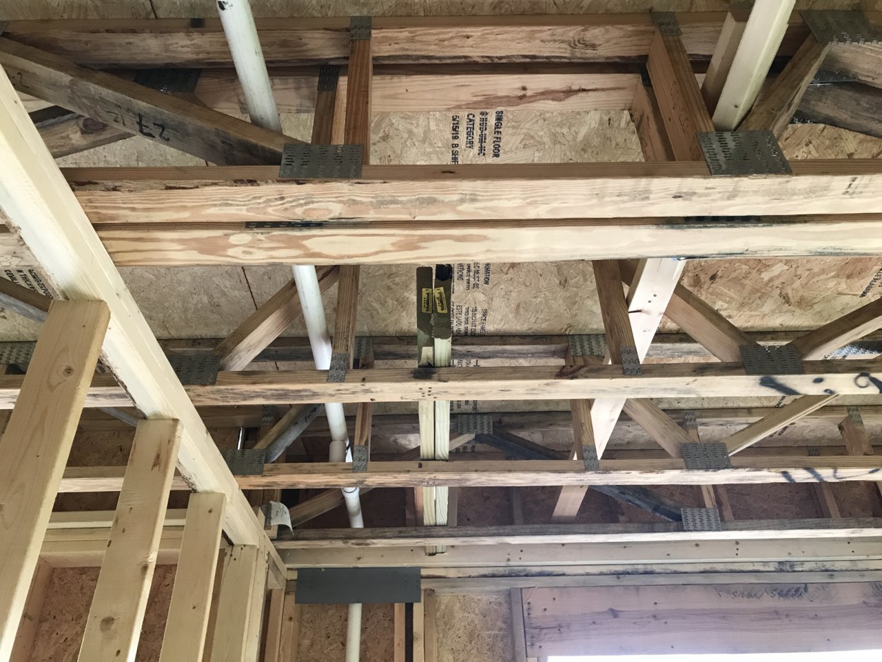

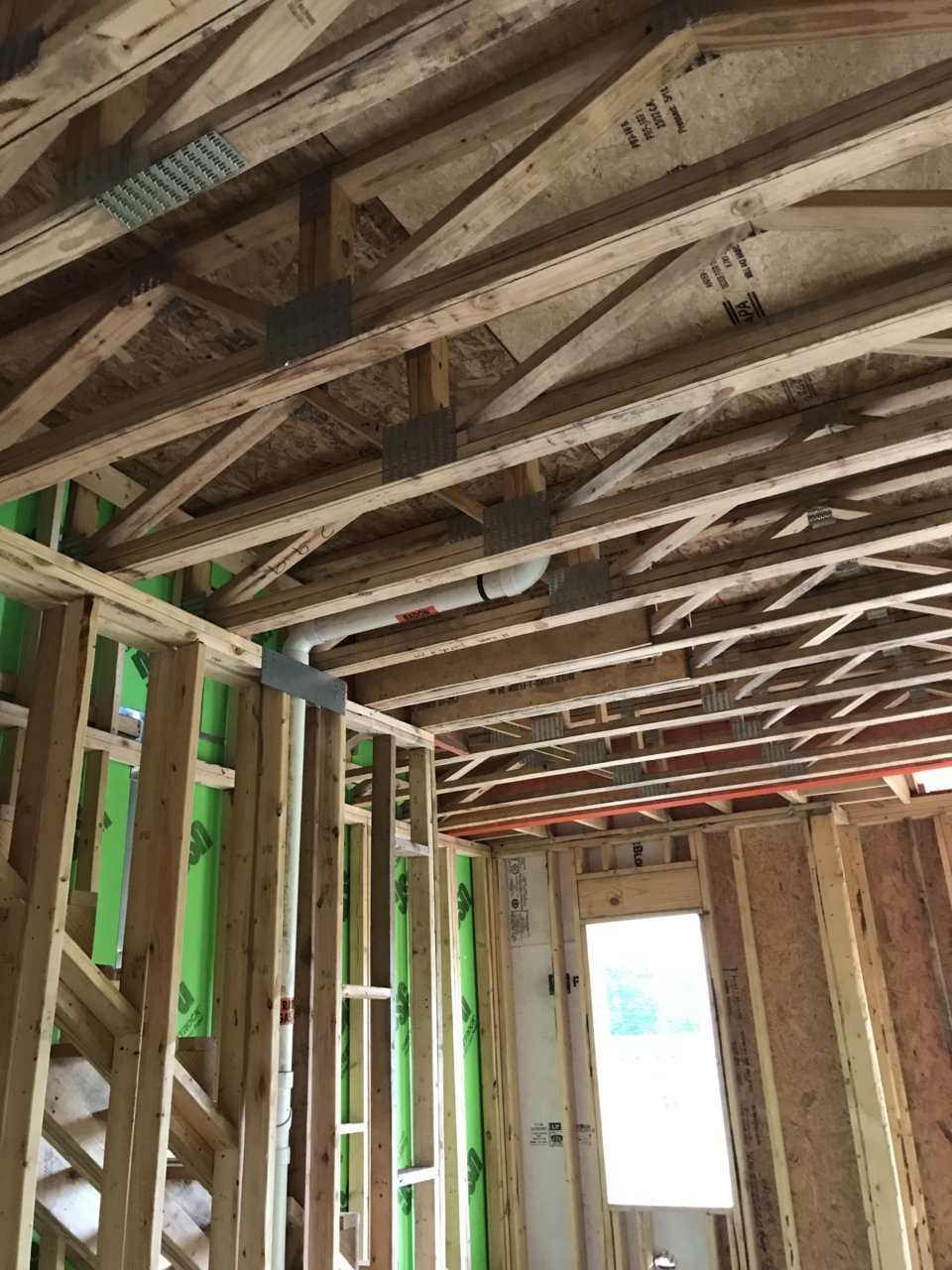

    I think I see what the deal is with those trusses - it's because of the balcony.
    Here's some updated pics taken from today.

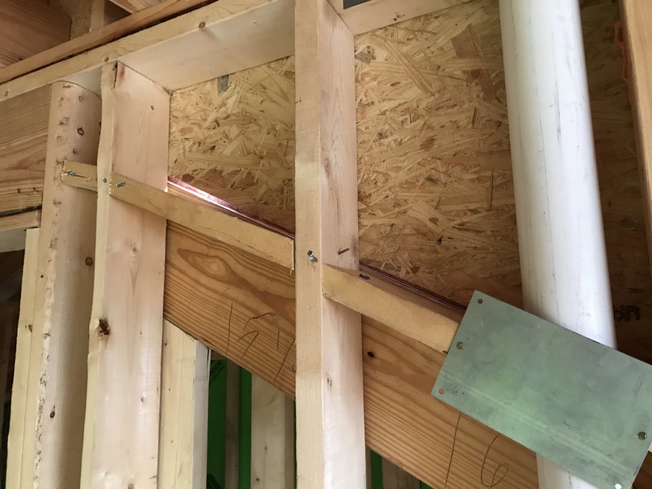

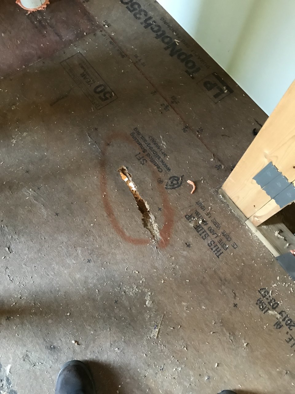

    There's several spots on the sub floor on the third floor that squeak and feel uneven. There's also a couple of spots that are not flush with each other or have swollen. Do I need to tell them to fix this? Or will they fix it when they put in the flooring?
    I've seen some "notes" spray painted in areas (like the orange circle around the hole) that indicate things that need fixing. I'm not sure how thoroughly they went through and inspected things like squeaking and uneven flooring. Seems like they just did a quick inspection.

    They have a framing punch list by now, things to fix while electric and HVAC are installed. All that will only take a few days. Then framing, rough electric, rough HVAC, rough plumbing inspections will happen. I see a pressure gauge on one of the water lines, which indicates a plumbing inspection is already in process (must hold pressure for 24hrs.) All inspections will happen in a day or less. If you haven't been able to make contact with the inspection people yet, you don't have much time. The GC will resist fixing anything framing related after it's been approved by inspectors. The bank will also look at it, and approve a draw (partial payment) or not.
    In all fairness, I have found 99.9% of inspection people are serious, dedicated professionals. Building departments cannot afford the liability of anything less.

    I am guessing that your townhouse is being built by a large developer. As such the developer should have a project manager or site superintendent assigned to your build. This person should be able to answer your questions concerning quality. The building inspector should be able to answer your questions concerning code.
    Quality and code are separate from each other but they are inter-related. For example, a sloppy paint job is a quality issue, squeaking floor can be a quality and code issue if the squeak is due to inadequate nailing and gluing of the subfloor. It does appear as though Nashville has building inspectors grouped by trades (plumbing, electrical, mechanical, general).

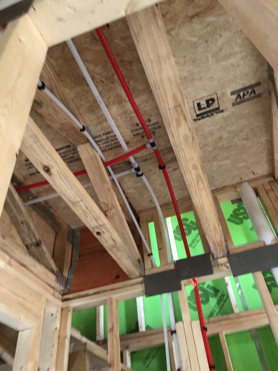

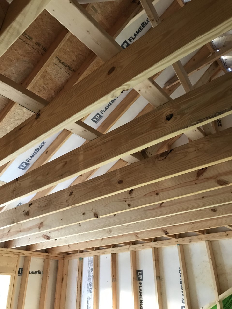

    concerning this picture, this is the master bedroom. I was under the impression that this room would be vaulted. Wondering if this framing is temporary?

  19. Jul 22, 2019 at 12:05 PM
    #139
    OZ-T
    OZ-T I hate my neighbour
    Dec 15, 2009
    #27584
    50,587
    Peter North
    British Columbia
    Not temporary
    tomwil likes this.
  20. Jul 22, 2019 at 12:10 PM
    #140
    ThunderOne
    ThunderOne [OP] Well-Known Member
    May 20, 2009
    #17473
    10,042
    Mitchell
    Nashville
    1ST GEN OR GTFO
    Toyota NERD
    that's what I thought, which is annoying because the other built unit had that ceiling vaulted.
