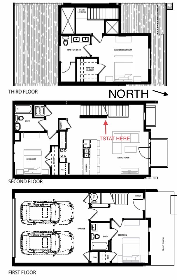

    They're supposed to use spray foam now. Before they were using batt insulation. But supposedly they were able to get a good price from the supplier so now they're using foam. I believe it is closed cell. Don't quote me on that.
    As far as the proper framing, yeah my guess is the framers didn't read the plans properly, and building manager probably doesn't go by there very often. I don't know if they are "done" with framing the vaulted part of the ceiling yet - it's only been about two work days since I took those other pics.

    I will say this, that is the only part of the upstairs that is vaulted. The rest of it is not vaulted. Not sure if that makes a difference. It is only vaulted in the bedroom part. Not the closet, the bathroom, or anything else.
