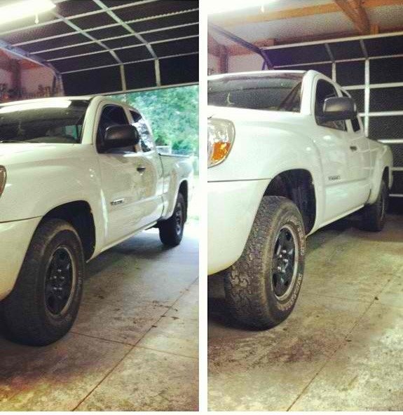

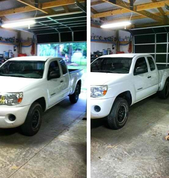

    Here's a couple pics of my truck. Just because
