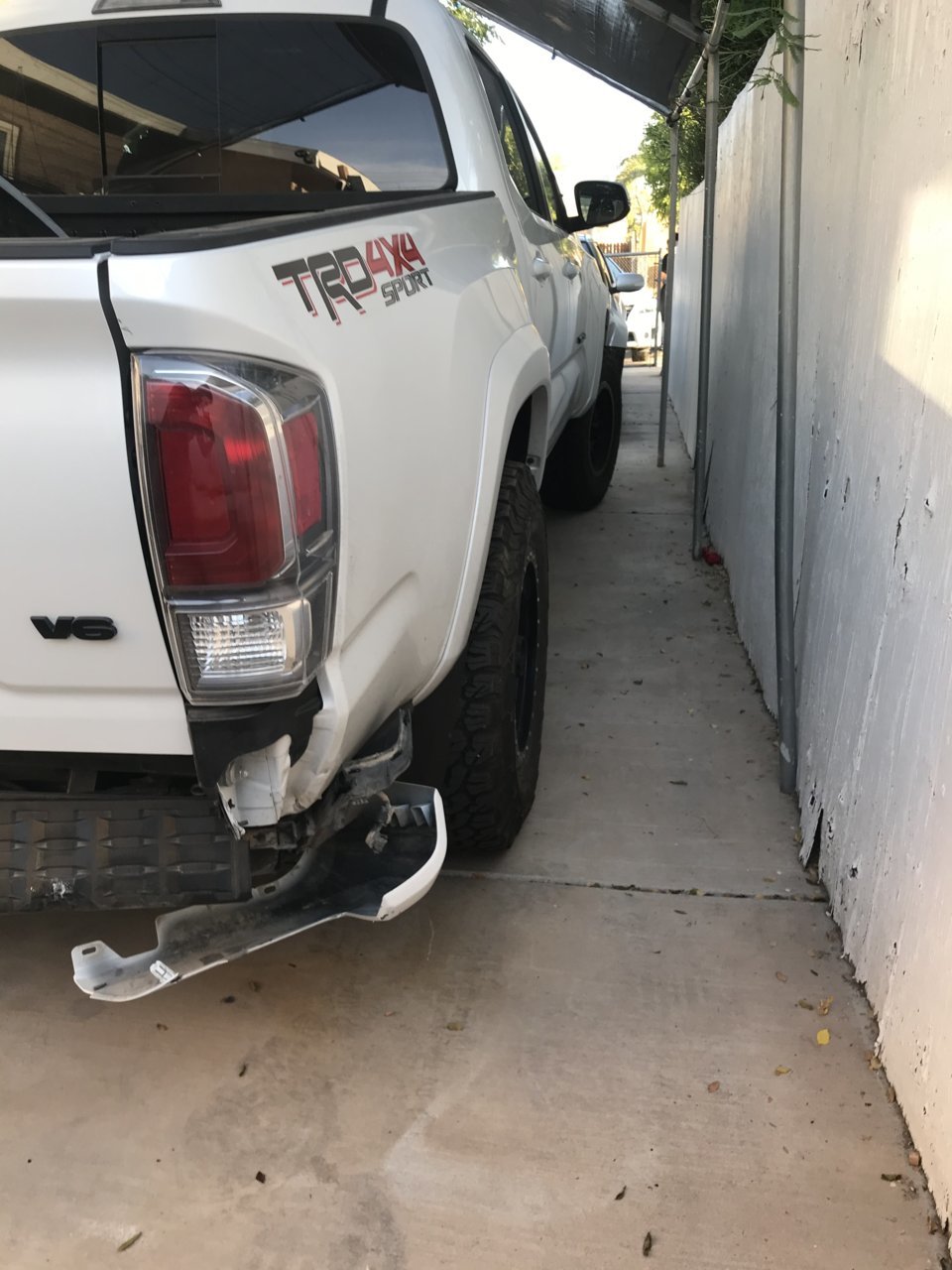

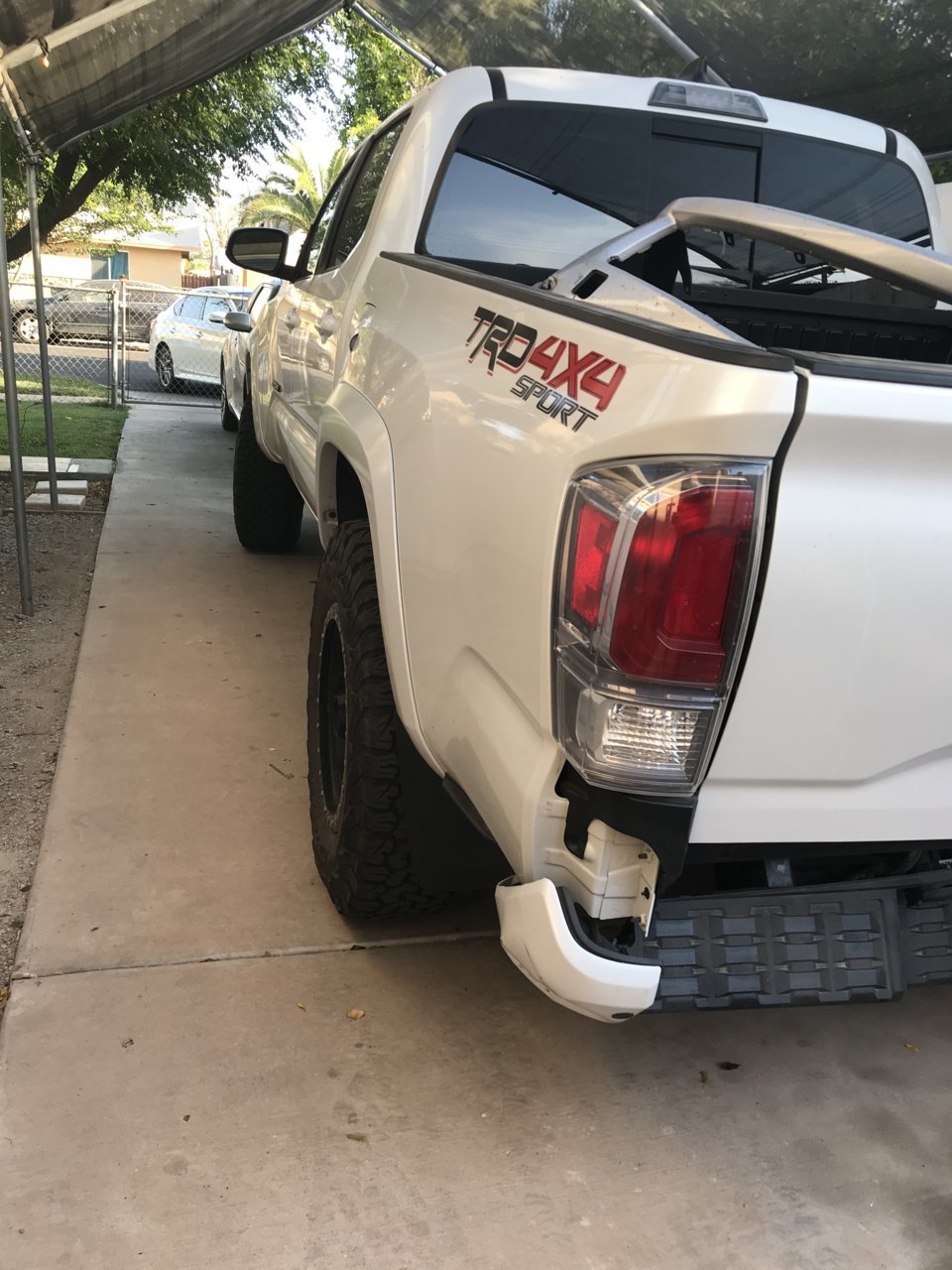

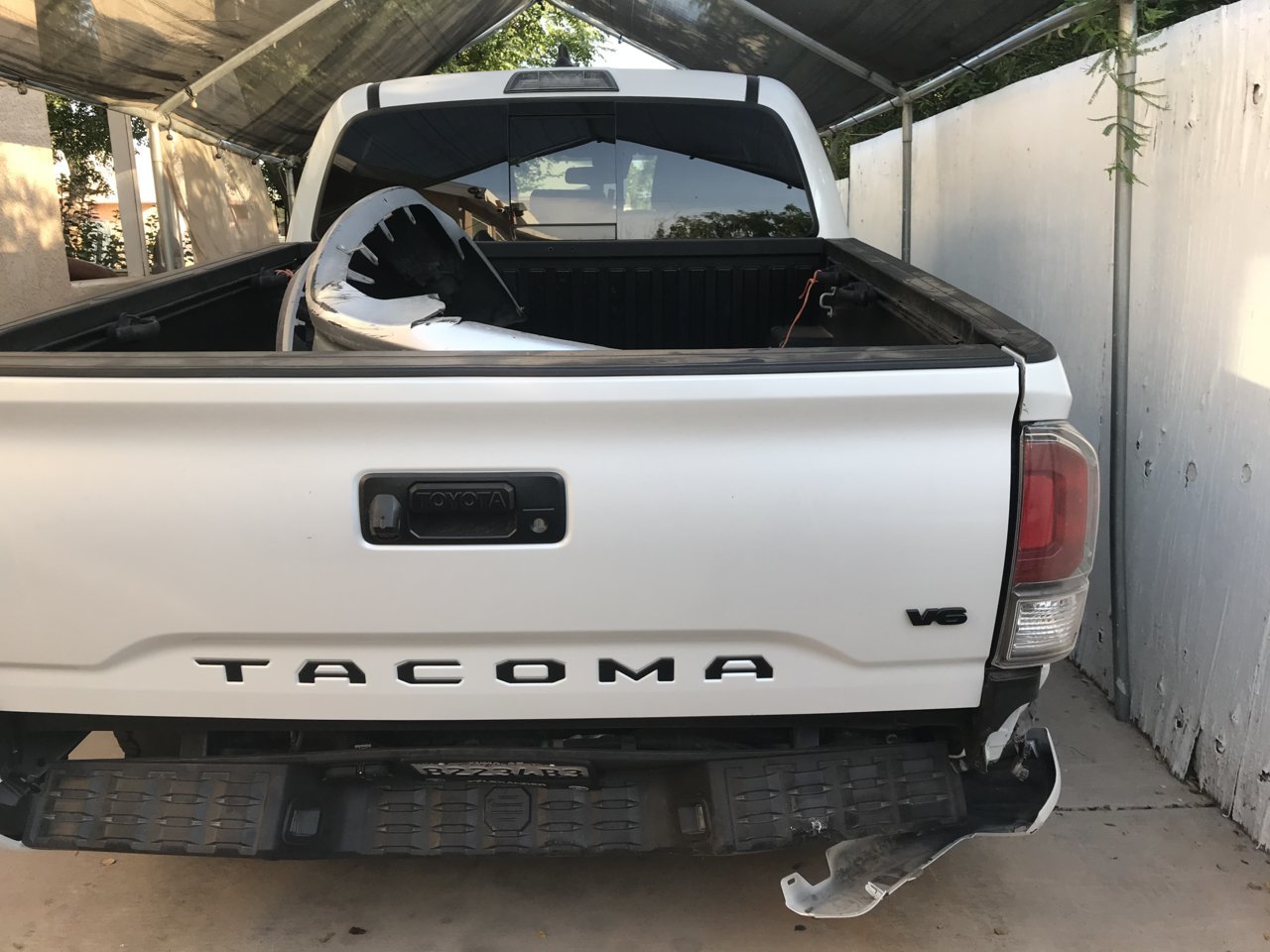

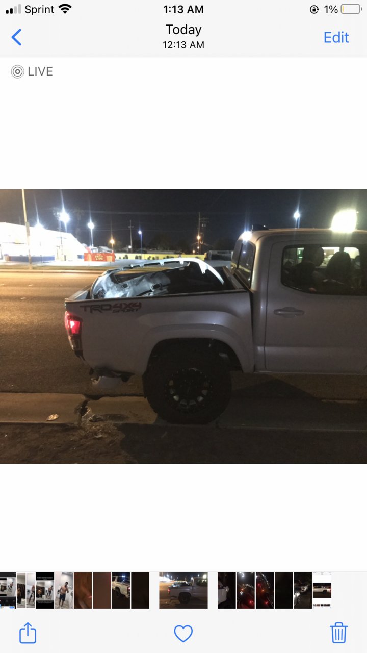

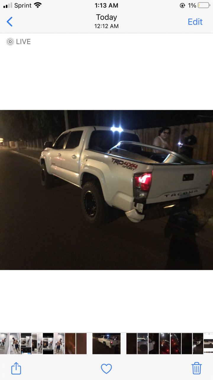

    Hey all! Last Friday night I got rear ended by my dumb brother who was following me and was on his phone. A stoplight turned red so I stopped and unfortunately he didn’t. His car ended up total but mine ended up pretty bad as well. I haven’t even had my taco for a year yet but I mean shit happens. I’m curious on what a repair for all this damage would probably cost. I’m also afraid they may total it for the frame creasing on both sides in the back where the hitch cross bar connects. The actual bed behind the fenders cracked on both sides as well. What do you guys think it would cost and do you think they will total my truck for the frame creasing? E0DD3D85-9EEB-4424-B5DD-0281A76A9D37.jpg FCC1D2EE-ADC3-4A01-98B0-41CC98E6616A.jpg C2D6FF94-5A75-4319-B443-BCB7BA2AF8D2.jpg 07527BC1-255D-4ABC-AF33-2A1E8BFBD763.jpg F24A3E82-683F-4E90-9B78-6863BA3E3F3F.jpg C4541822-A10E-4B12-9F17-8F11E170CDB7.jpg E0DD3D85-9EEB-4424-B5DD-0281A76A9D37.jpg

    That frame needs to be replaced. 100%. It could go either way, repairable or total loss. The value is so high it might actually be repairable. Do not let any shop repair that frame. Toyota does not recommend any of their full frames to be pulled unless it's "cold straightened." Yours cannot be cold straightened.

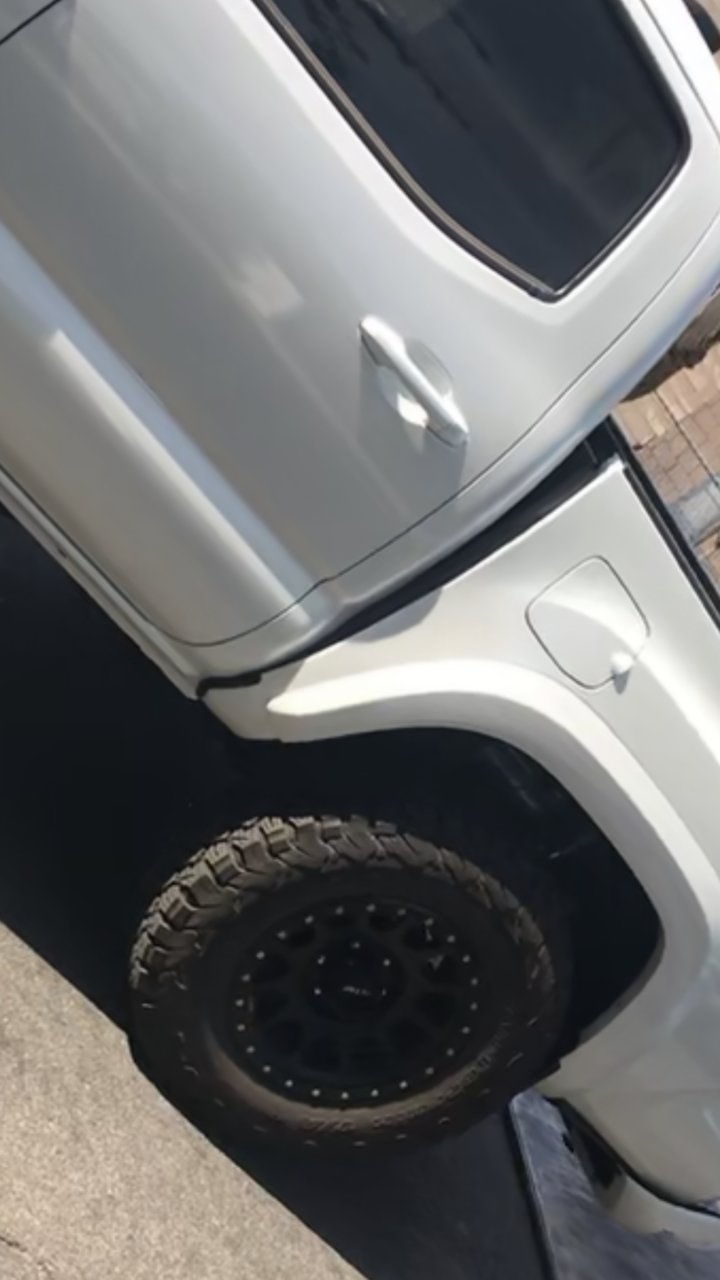

    Frame looks bent, Did the bed bump the cab at all? if you need a whole bed, frame and cab damage it's a total loss.

    If I’m being honest I am not 100% sure if it did or not. But from the few pics I do have it may have slightly hit on the bottom where the bed and cab meet. Not sure if their is a dent or just paint damage on the cab.
