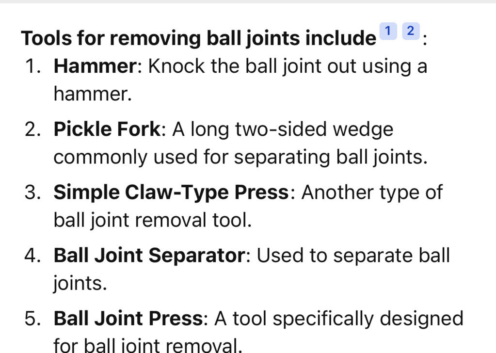

    2015 DCSB SR5
  7. Nov 28, 2024 at 1:44 PM
    Afilao
    Afilao [OP] Tacoma Driver
    May 30, 2020
    #329818
    703
    SoCal
    ‘18 MGM DCSB Off-Road 6MT
