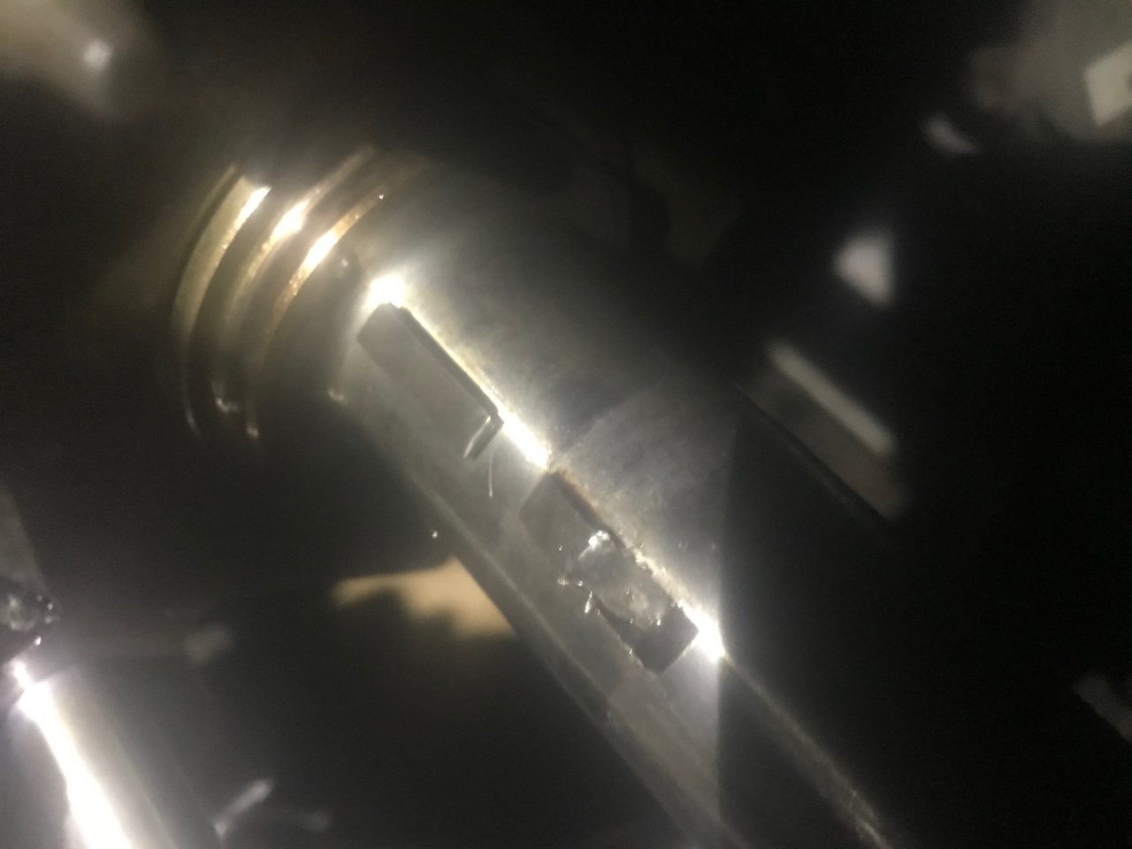

    This is slowly turning into a nightmare.
    The front woodruff key that drives the crankshaft pulley has sheared off.
    I ordered another woodruff key that I plan to install. My question is, how the hell do you remove these keys? Drill it out? I've tried using penetrating oil and a hammer/chisel to no avail.
    Any tips?
    Thank you.

    Might try a propane torch to heat it. Usually you can get under the edge to pop it up with a screwdriver or chisel. Or hit one side with a punch and get it to rotate up on the other end.

    I have never removed one but i would turn it to the 6 o'clock position and let gravity work for me while tapping on it with a punch and applying heat.

    if they are half moon shaped on the bottom, a tap with a punch and hammer straight down should force it to rotate and ride out. If they are flat, a sharp small metal chisel struck from the side might loosen it up. If it distorts the key that gives you a grip for the vise grips or large end-cutters, not side cutters, end cutters, to get a good grip on it.
