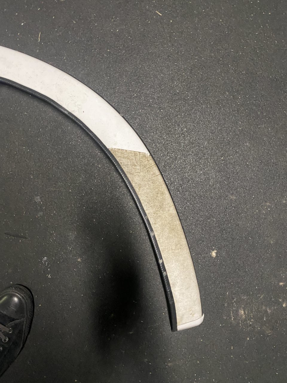

    Need some help removing this nasty material from fender flare.
    I don’t wanna damage paint. Got mold in it. CEB28ACD-434E-4700-B646-E659451E6C95.jpg

    Heat gun on lower setting and a lot of time and patience.

    I took mine off. Heat gun. And plastic razor
    Took me 15 mins a side
    If you use a heat gun be careful
    Hair dryer may take a bit longer

    thanks guys. I’m gonna try it
