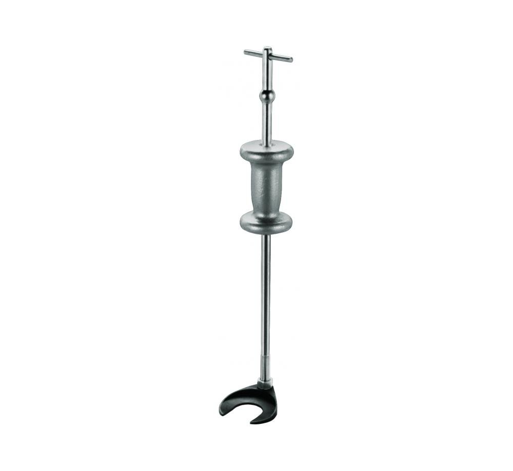

    for everyone else.. if you have the pickle fork (ball joint seperator) use that.. put between axle shaft and housing.. give it a good whack and it should come out.. i like the loop and swoop method though.. Good thoughts.. :) Next time i may try that since my pickle fork now looks like a pickle spoon.. :p

    I guess my pickle fork was just weak.. the prongs bent when doing this.. but it did seperate.. :)

    Pickle fork for the win!

    I wound up buying one of these for a stubborn ass frozen CV axle/bearing on a 94 Camry (on the passenger side with that stupid carrier bearing). I had to get the 10 lb slide hammer and extension. Beat on it for 15 mins straight before it let loose. Apparently had never been changed in 25 years. :frusty:

    Its really easy all those slide hammers and whatnot arent required. Use a simple pry bar pry turn pry turn, it will get to the right spot and pop out easily.
