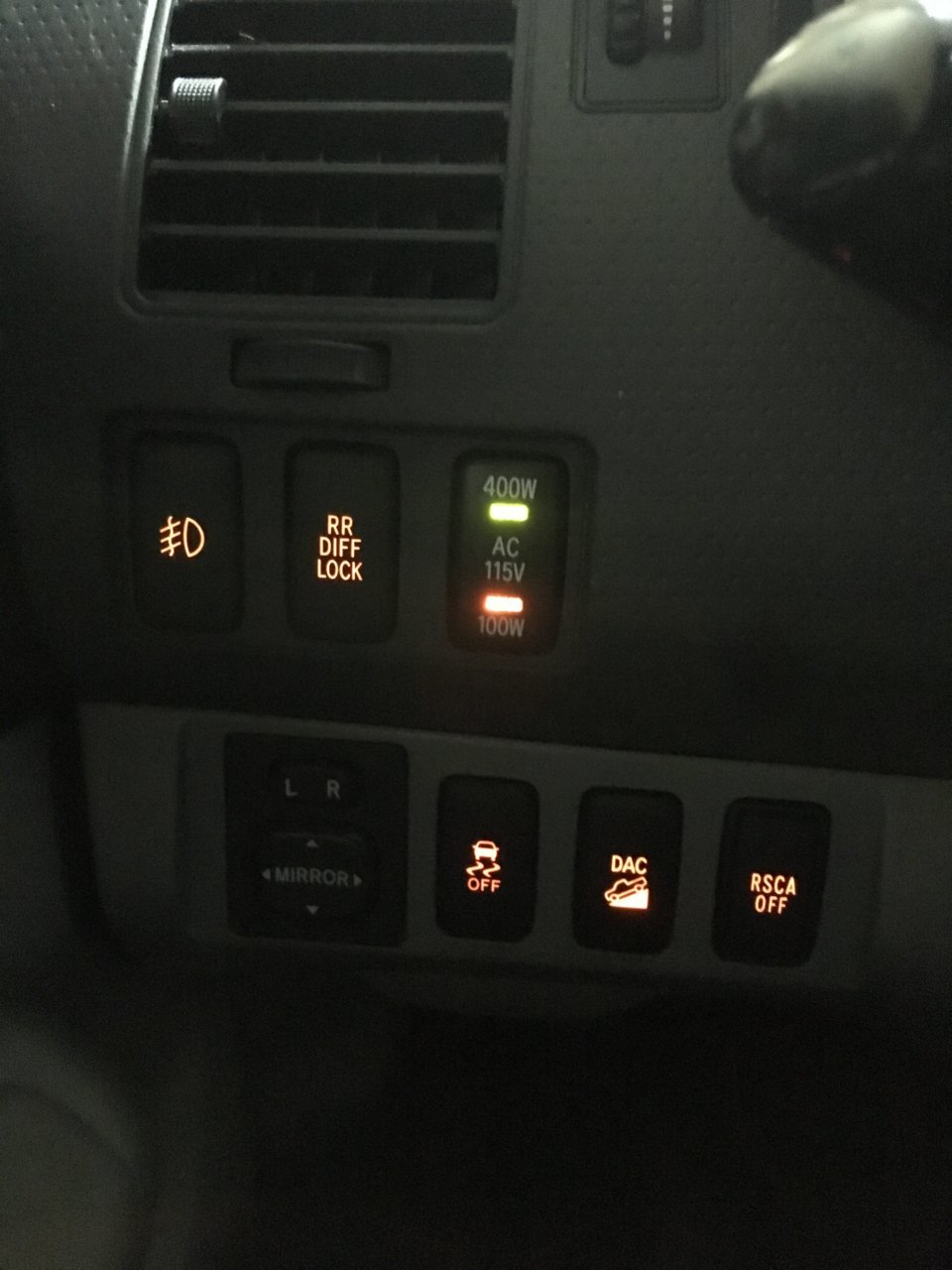

  8. Dec 14, 2015 at 1:41 PM
    Sandman614
    Sandman614 Travis #hotsavannahdotcom, LRGRNR
    Oct 26, 2010
    #45273
    27,320
    Tim
    Boone, NC\Garner, NC
    '06 SR5 Off Road
    Thanks for the link.
    I'm swapping mine out for this switch for my light bar! #aironboard
    igno1tus, mrkabc and Old School like this.
