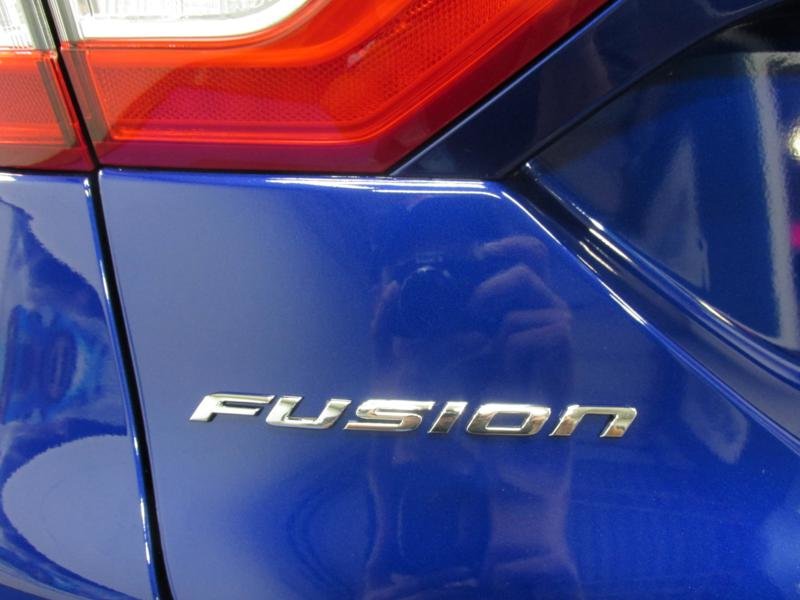

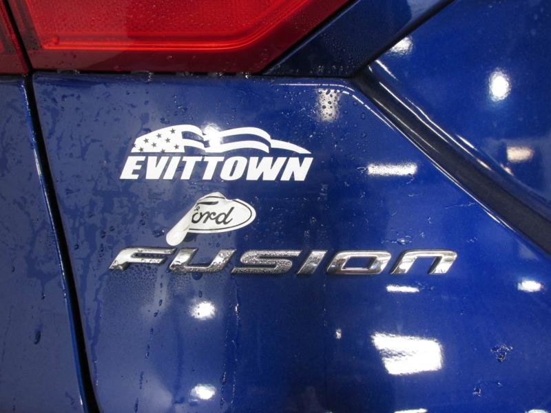

    Looks like I'm late to the party here. For anyone in the future...
    Heat gun and plastic razor blade to remove the stickers (be gentle). For raised lettering, heat gun and braided fishing line. Then roll the adhesive onto itself
    Then Stoner's Tarminator to remove the remaining adhesive
    If its been there awhile, likely you need to compound and polish the area to remove the 'ghost' or 'shadow' of where it used to lie
