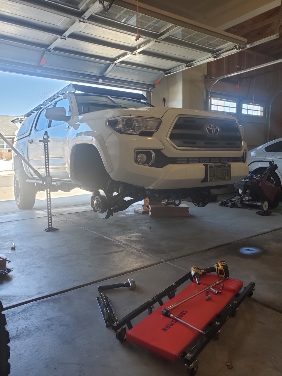

    What's the trick to get the sway bar out without cutting it?

    Please use a jackstand on that passengers side. Please!

    Remove skid/splash plate. Unbolt the two mounts and two end links. I can’t imagine why cutting it would be thought of as an option.

    As alluded too its 2 bolts I think and then you have to move it down/up at a certain angle to get it out. DO NOT CUT IT.

    OMG this ^^^ just saw the stack of wood and jack stand only supporting the drivers side, thats some sketchy sh*t I wouldnt feel comfortable climbing up under there.

    Nothing like laying under there with a suicide jack. That shit is sketchy as hell

    I see we have another jenga player here.:anonymous:
    Jack stands harbor freight like 20 bucks.
    Dont cut as mentioned.

    If you have the front skid I unbolted the two braces as well. That way it dropped out. Not sure what SR or sport comes with.

    There's a Jack stand under the driver side.
    Just wanted to know what I was missing with sway bar removal.

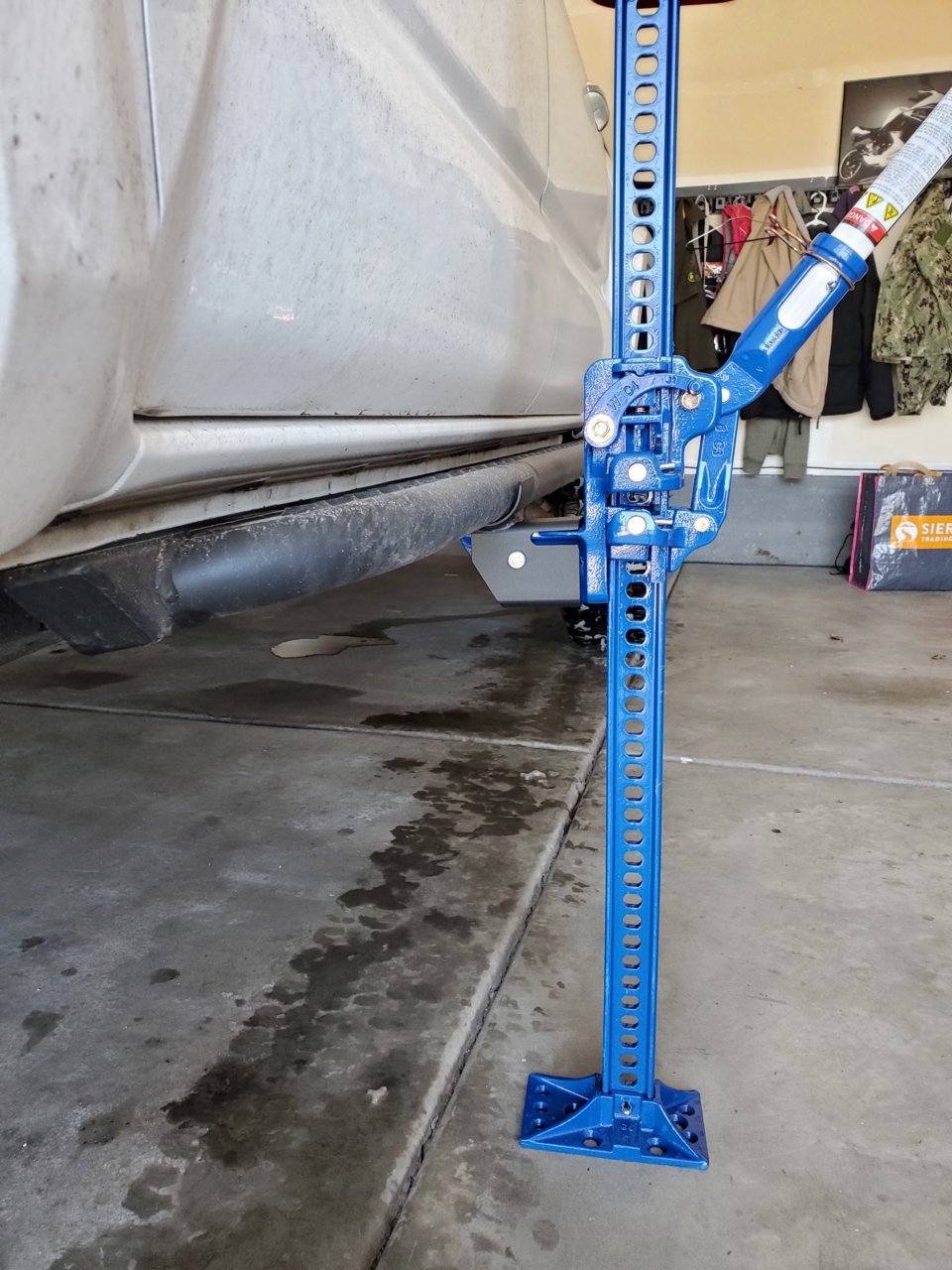

    Yikes and is that jack holding the steps!?

    It's holding the sliders. And they're fine.

    You did post a picture of a unsafe death trap. People are going to give advice to keep you safe when you post pictures like that.

    Those maybe to short! He is going to need some in the 20"+ range

    Unassisted hilift is death in disguise
    For the sway bar. Unbolt from spindles and unbolt the 2 hangers on the frame and remove.
