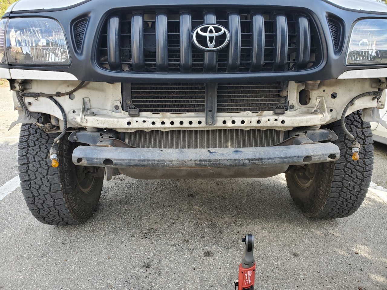

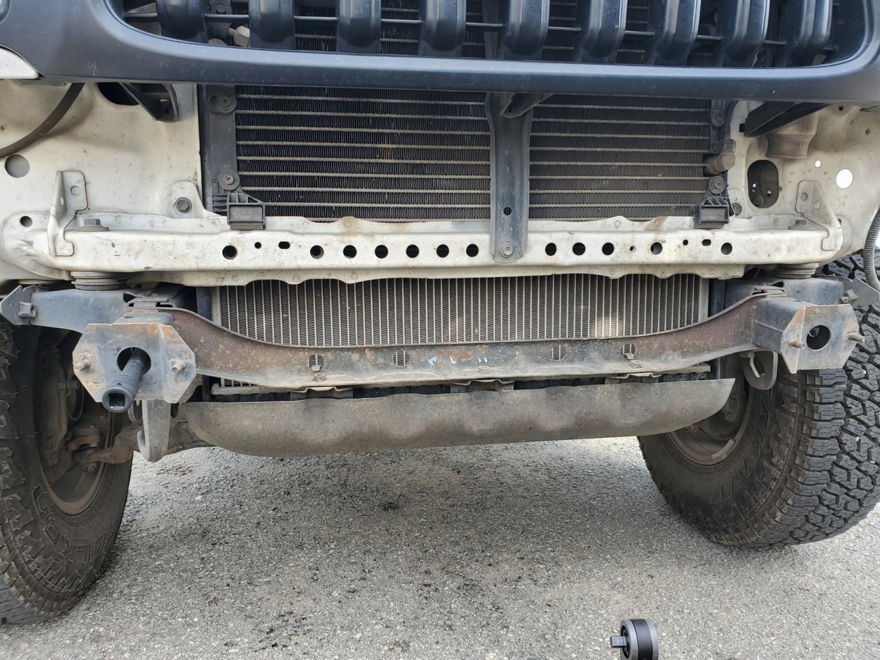

    This is how it'll look like when you remove the bar. You'll see the two bolts on each end that hold the crash bar.
    Ignore the extension sticking out; these were from when I installed an aftermarket bumper.

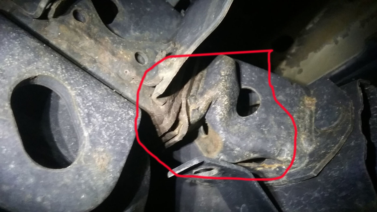

    I got the bar from Rock Auto for under $20; shipping seemed cheap too (can't recall it). Obviously the bar is the real energy absorber, not the plastic. Likely saved my radiator and other parts. Still do not see how the brackets they sell work with it. Also crushed one of those 2"X2" (just guessing) tubes, which look to be out of perhaps 1/8" steel. Not finding that part, so will need to find a way to fab one up. Probably put this off until the weather warms up in my barely heated garage.

    That is a very kind and generous offer. I think I have the parts I need (bar and valence), but greatly appreciate the offer. The only part I'm not sure how to attack is this bent tubing. Thinking I'll find someone local with a plasma cutter, then weld on some thin tubing.

    Let's try the picture again.
