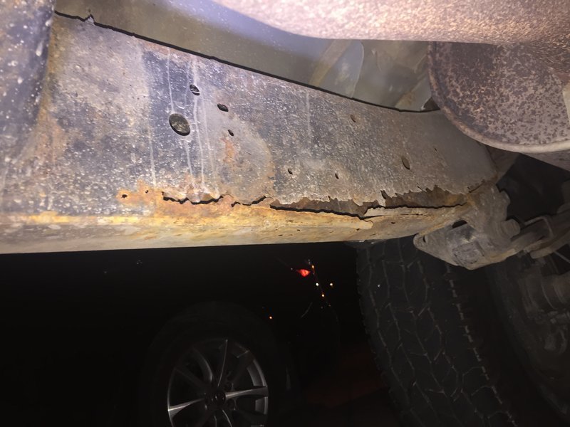

    Climbed under my truck not long ago and noticed a pretty rough spot of rust in the frame. Anyone have any suggestions on repairing? I was thinking of having it patched and then coated.
    Overall the frame is pretty solid but this section looks bad.

    That's pretty bad. Have you checked the status of your frame warranty with Toyota? An '04 would still be covered if the warranty conditions have been met.

    Yeah, hopefully you had your frame treated by Toyota (prior to 2011 I think it was?), if you did then you'd definitely qualify for a frame replacement. That looks bad, I'd be wary of driving that around. Call Toyota Corp. and have your VIN handy to see if you qualify if you aren't sure whether or not your frame was treated in the past.
    If you don't qualify for the replacement then you could always patch it and weld it, won't be as good or strong as a new frame but definitely better than where it's at right now.

    Thanks for the quick response guys. I don't think it was treated but I'm definitely going to reach out to Toyota to see what they say. I've had this truck over 10 years and trying to stretch out its life as much as possible.

    Sounds like you owned it during the critical time in the frame rust service campaign when the undercoating was required. Were you in a cold weather state back around 2010? If not, you may not have been notified by Toyota. Call them and find out your status.
    I have to agree about driving a truck in that condition. My dealer would not let me drive mine off the lot after a frame inspection, and it was nowhere near as bad as yours.

    To be clear, this was never a recall, but a warranty enhancement (extended warranty on the frame, model years 2001-2004, for 15 years from the vehicle "in service" date) on the frame as part of a service campaign for trucks in certain cold weather states (CT, DE, IL, IN, KY, MA, MD, ME, MI, MN, NH, NJ, NY, OH, PA, RI, VA, VT, WI, WV - no mention of Canada in my notice, so your rights may vary), provided the owner had preventative maintenance (undercoating) preformed by Toyota before the service deadline back in the 2010-2011 era (2012 in NY).
    Your state is not listed, but I don't know what may apply in your circumstances. Toyota HQ will have to answer that for you. Call them, not the dealer. Good luck, and keep us informed.

    Just for the record a repaired frame done correct will be every bit as good as the original if not better .
    Done correct is the important part
    To the OP I guessing you were unaware of the frame Issues ??
    Maybe thought you did not have enough winter to be a problem.

    Just got off the phone with Toyota today. Got an appointment set up to inspect the frame to see if its eligible for replacement. They indicated over the phone it would be. However, they did say current turn around time is about 10 months on a new frame. I'll give everyone an update once I return from the dealer.

    In the process of doing this with my 02, i have a 2x6 hole by the passenger shock mount all the way through. my truck was coated by toyota so they honored the frame replacement. Wait time is like 6+ months though and they deemed it unsafe to drive so its parked on the dealer lot until who knows when. You will probably be deemed unsafe to drive and go through the same thing as me. Good luck

    Andrew, this is very good news. Hoping for a good outcome in your case. There is no conceivable way a frame in that condition would pass the 12 point frame inspection.
    My dealer set me up with a loaner during the replacement process. It was a brand new 2012 truck with under 500 miles. At the time, I did not use my truck daily, so I did not use it much, if at all. And back then replacements were only taking a week or so. Therefore, it sat in the driveway. That would be different today though.

    Toyota did deem my ride unsafe. Waiting on field inspector from corporate to come in and verify the frame condition. Then, I should know the next step in the process.

    If you want to protect against further rust....
    Remove rust with a wire wheel attached to a grinder.
    Hand sand with coarse sand paper (60-80) grit, a cross-hatch pattern is the most effective. If you can sand blast that's even better, but most likely not an option.
    Once area is thoroughly abraded, wipe clean with a solvent soaked rag, (acetone works great) stay away from mineral spirits as it leaves an oily residue.
    Apply 2 coats of Tnemec 135 Chembuild @ 4-6 mils per coat. It will prevent further rust from moisture and chlorides.
