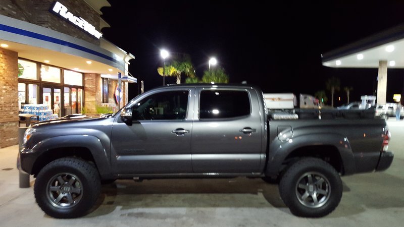

    Here's 5100s all around, front set at 0
    OME 885 Coils
    Wheelers Offroad 2" AAL
    265/70r17 Gener Grabber AT2s
    Rides like a dream and the lift only cost 650.

    That is exactly what I want!! Thank you for posting that. Now to order this crap before I change my mind!
