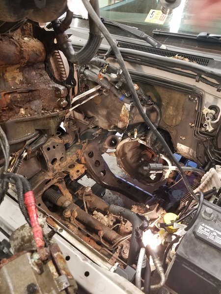

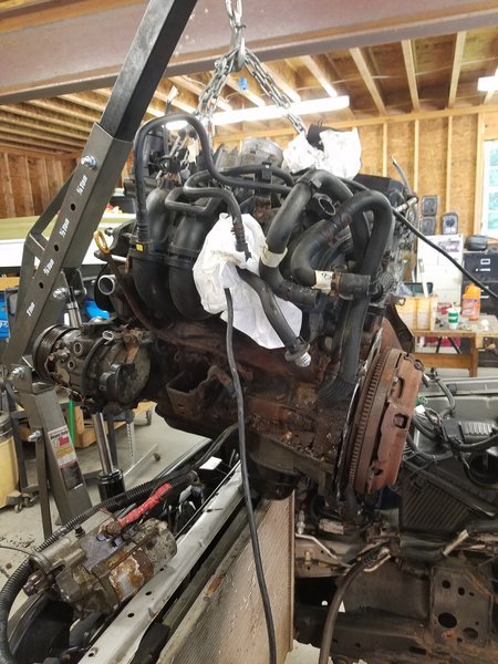

    It's out! Just needed to pry on it a bit. Thanks ruggybuggy. Couldn't believe the amount of rust on the block. Now that the motor is out I'm thinking of taking advantage of easy access and replacing as much as possible. Replacing oil pan, clutch, timing chain, anything else?20160813_123845.jpg 20160813_123852.jpg

    Replace that throw out bearing

    Wow that's a lot of rust! POR15 will take care of that. I would even do the motor.

    was the truck submerged? tons of rust

    Truck is only 8 years old... Can't believe the rust...at least now I'll know it'll last for years to come

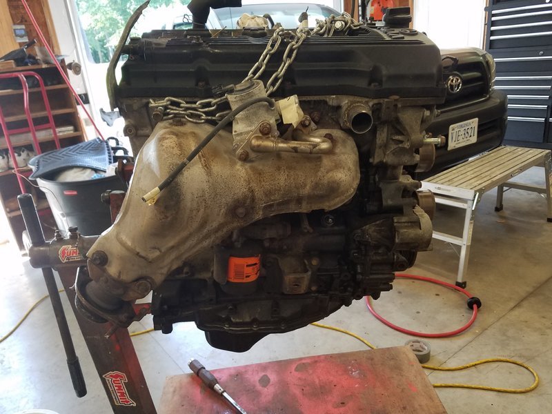

    Motor is out and I'm in the process of pulling the oil pan. About half the bolts were rounded off due rust and it appears my leak is coming from the pan. Gonna order some more parts online. Would you all recommend doing anything with the timing chain? Truck only has 125,000 miles and no evidence of wear on the chain. I may just let it be and avoid the hassle of pulling the timing cover. Thoughts?

    I would leave it alone. The 2TR doesn't have any issues with timing chains.
