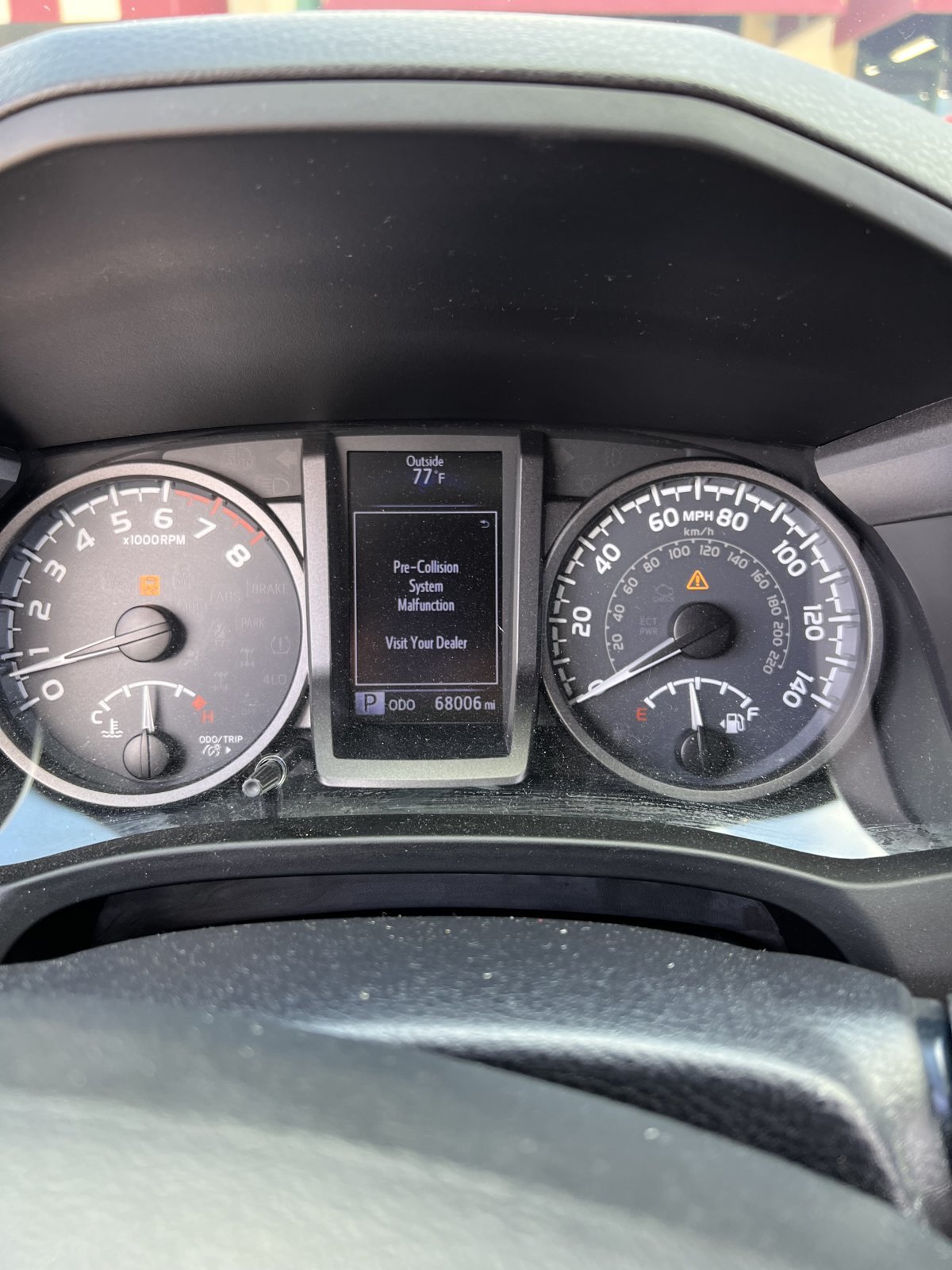

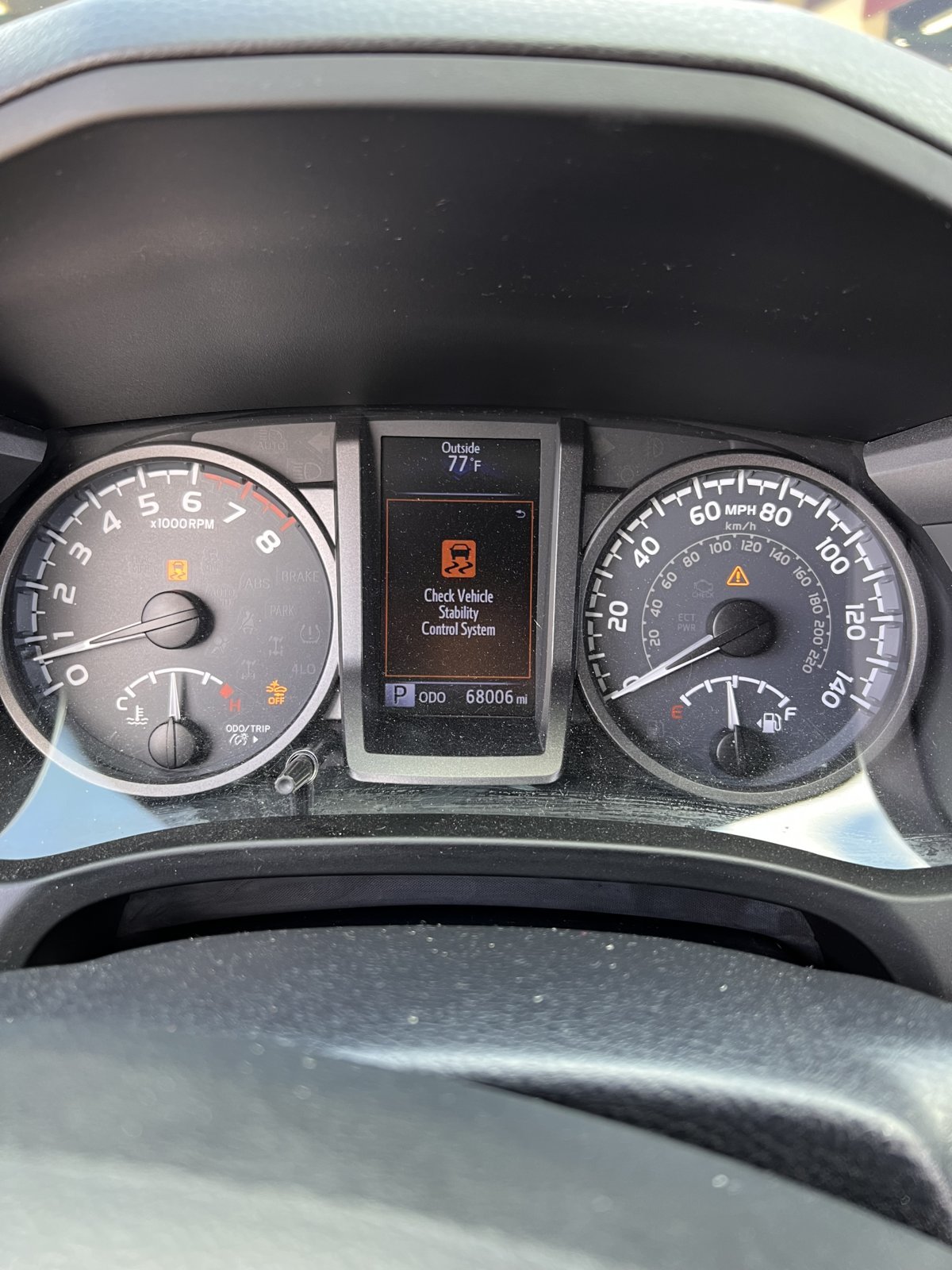

    IMG_5703.jpg IMG_5702.jpg So a friend of mine just installed Bilstein 5100’s front and rear on his 2019 OR. For some reason getting these warnings on the dash now. Pre-collision malfunction and stability control system warnings. Any advice?

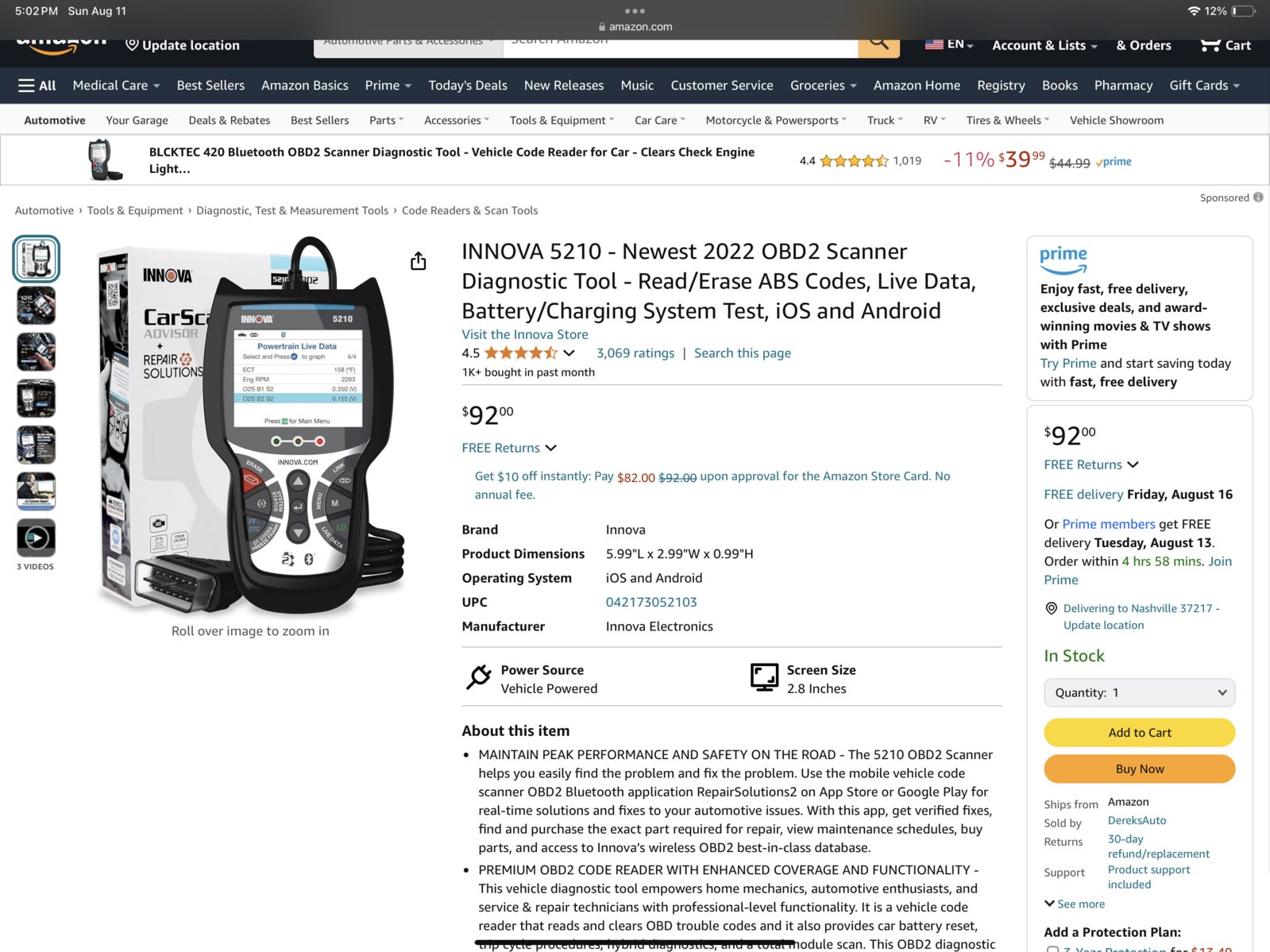

    You need this to do zero point calibration if I’m not mistaken. You can do it yourself.
    https://www.amazon.com/INNOVA-CarSc...d43bd64f06c3322b94d76723e4d367c4&gad_source=1

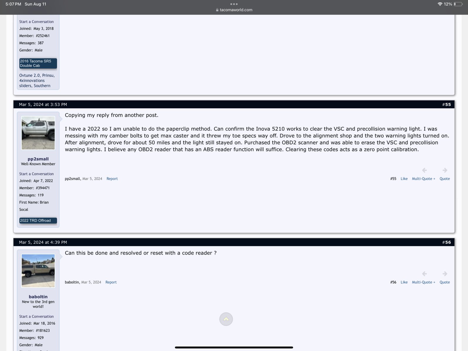

    A quick search. An old thread retrying the fix using inova 5210

    I had similar alarm pop up on my 18 after installing pro suspension & replacing UCA’s/LCA’s.
    After alignment, I had to get in techstream and clear the code. If I recall it was some sort of angle sensor error causing it.

    Clearing the VSC cleared everything for me when I got it after swapping coilsprings.

    Paper clips don’t work on all. I’ve tried it. What someone said in the comments, use one of these tool scanners. I used innova and cleared it compared to how much a dealer is willing to charge you. It’s Amazon, return it or keep it.
