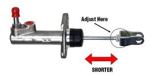

    Somewhere you might see something like this. I don’t know what vehicle the picture showing the part is for.
    The goal would be to shorten the rod which will increase pedal travel. It’s a little tricky. Grab the rod, with the pedal up, it probably feels tight. Shorten slightly, grab the rod again, keep shortening until when you grab it it’ll rattle a little. You want it so it’s just barely short enough to rattle. Tighten the lock nut. Get in the seat and use your foot to see how it feels. You should have some travel but nowhere close to hitting the floor. You might need to start it to get the booster going for this.
    Keep in mind this is a generic instruction. Someone will hopefully chime in with access to the manuals.
