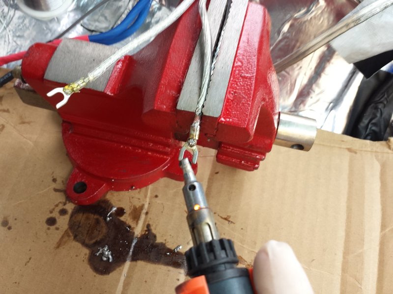

    Heres the thing. See in the Knukoncepts kit im using (never using a kit again). The 14 guage speaker wire is also copper clad aluminum. That has soldered fine using a iron with rosin flux and 63/37 solder.
    Im using a Portasol '75 watt' butane torch.
    The power cable, that is what is not taking anything. I tried using the iron with the same rosin fux and lead solder. No go. I switched to the torch, it just made a mess, thought the solder did bond to the ring terminal.
    If there was some chemical coating on the wire, wouldnt the flux take care of it? Is there a chance a larger iron is the way to go? I think i have a old pistol style soldering gun in storage.
