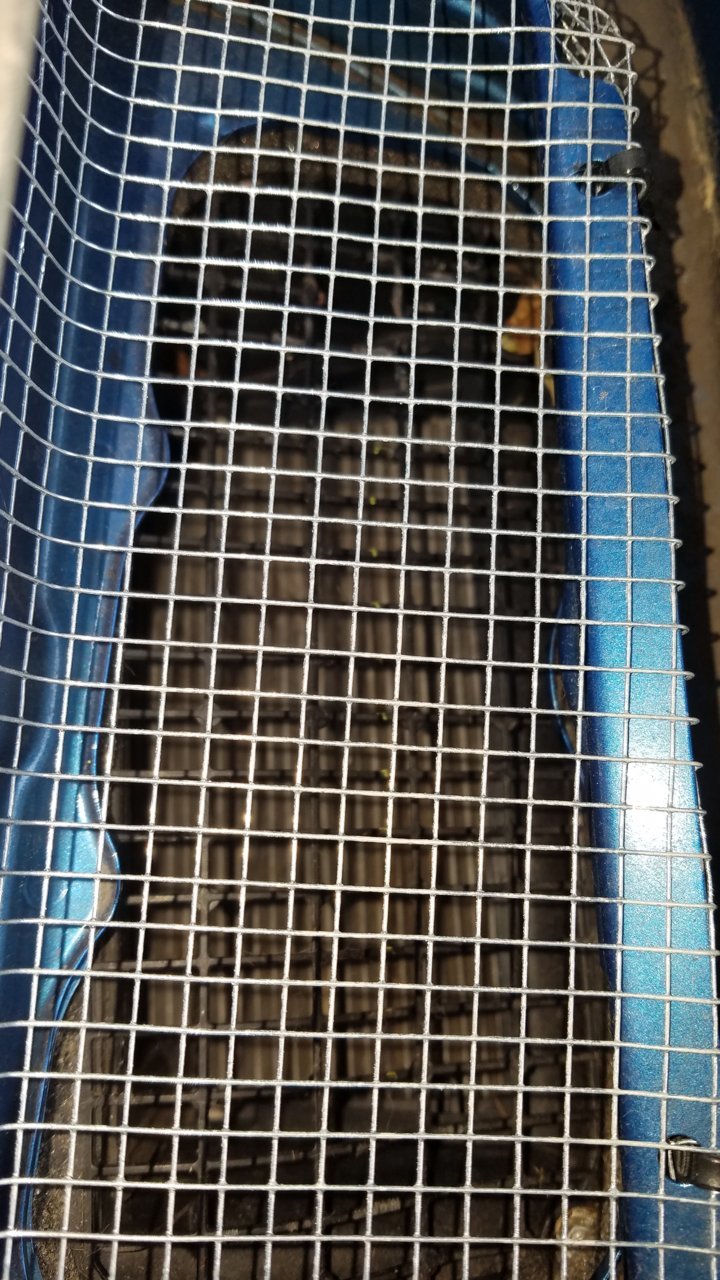

    Outside. After seeing them in the Tacoma now too, a garage is getting built in the spring.

    Client complained about dead rodent smell coming from the wall about "there". Found it cutting throught the drywall when the sawzall blade started coming out bloody. They were dead on. Pretty easy to pop the cowling above the intake and screen it.

    JJ18ORDBSBMT, over60, presto and 3 others like this.

    well done my friend..:thumbsup:
    That should keep those critters outta there.

    If not, I could try this approach:

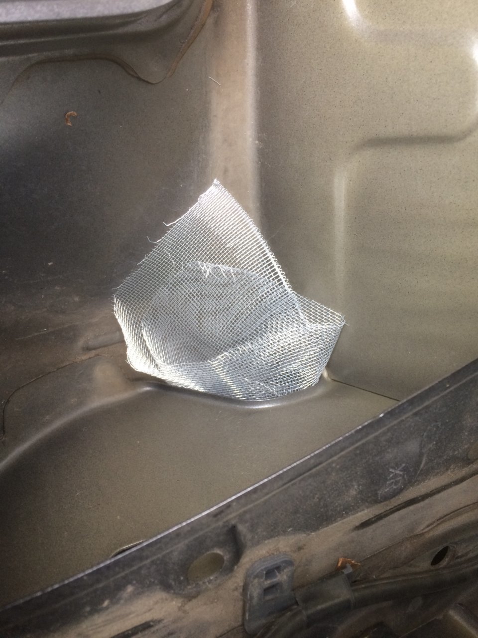

  20. Nov 11, 2018 at 6:34 PM
    #60
    Treerat
    Treerat Well-Known Member
    Jul 4, 2016
    #191185
    62
    Louisiana
    2016 TSS Grey 4 Door V6 Special Edition SR5
    Got in my 2016 yesterday and rat piss smell. Took out ac filter and full of turds and pee stained filter. Cleaned it out very good and changed filter. Checked engine filter and same thing, full of turds. I took the air filter box out and pulled off the end cap and covered opening with aluminum window screen. Then i took wiper cowl off and covered ac vent with double layer screen and made 2 cone pieces and shoved in corner holes. I put 12 glue boards I under hood. Waiting to catch he lil sucker.
