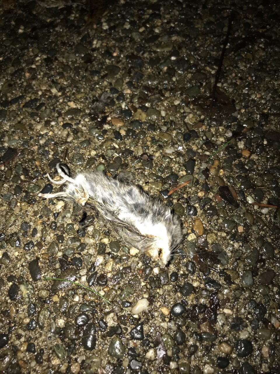

    Had some dirty sock smell whenever I would start up the truck, but would go away. Was messing around with others proposed fix of Lysol down the fresh air intakes. Did one round last week and another tonight and guess what I found sitting on top of the filter! Little bastard
    I guess I was lucky he chewed a hole in the grate that allowed him to fall through. Otherwise I probably wouldn’t have found him ever.

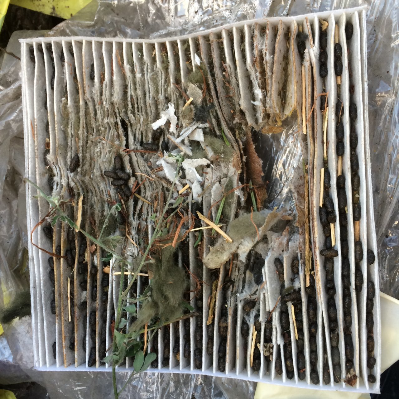

    Welcome to the club! I almost accused my local oil change place of planting this so they could sell me an overpriced replacement filter but then recognized this was more than a quick sprinkle of mouse pellets. Most of debris is the insulation off the engine firewall which needless to say is now missing from my truck spread over countless other mouse nests. I just feel lucky they don't chew on the wiring like they did to my other car.

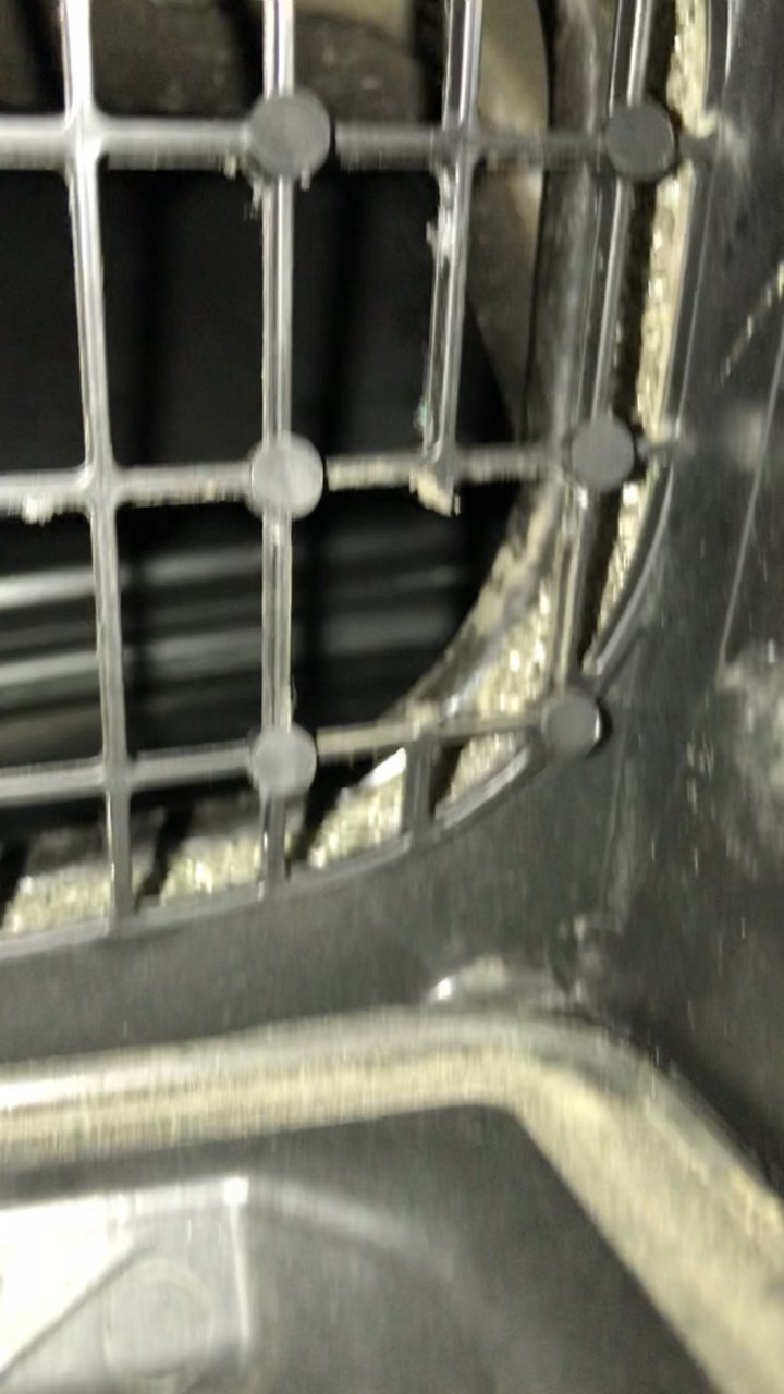

    They do, but it's made of plastic. The mice chewed right through mine.

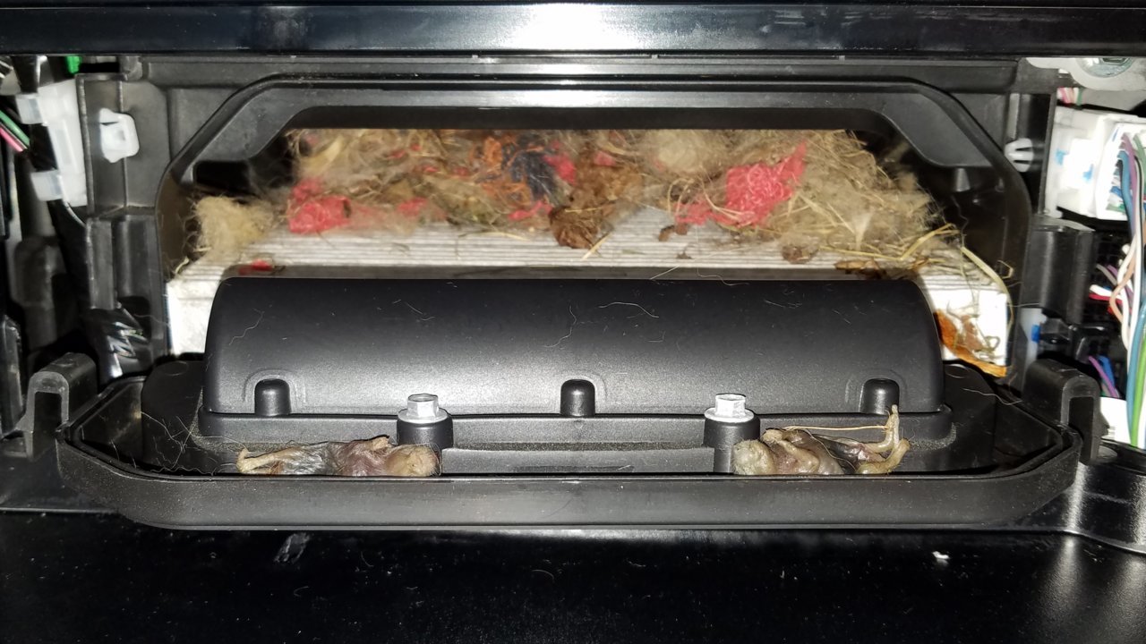

    Glad I found this. There is a stench in my cabin filter area & removed filter and found mouse droppings in the filter. Removed wiper cowling (as above) and everything's clean, pulled out blower (per Toyota dealer) and nothing. Could it be behind the dash, somehow? How would I go further?

    Your filter is visible through the intake with the vent set to outside air. There isn’t any “further” unless the mouse chewed through the filter and somehow got past the fan. It’s probably just pee on the fan blades. There are some flaming duct cleaners for auto AC’s. Pull the filter, set the fan to high and spray it in. I used ~1/3 can at a go and it did the trick.

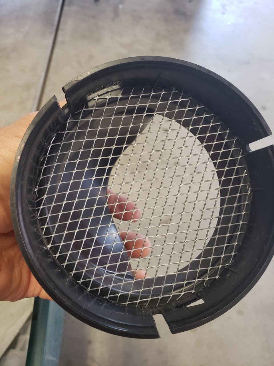

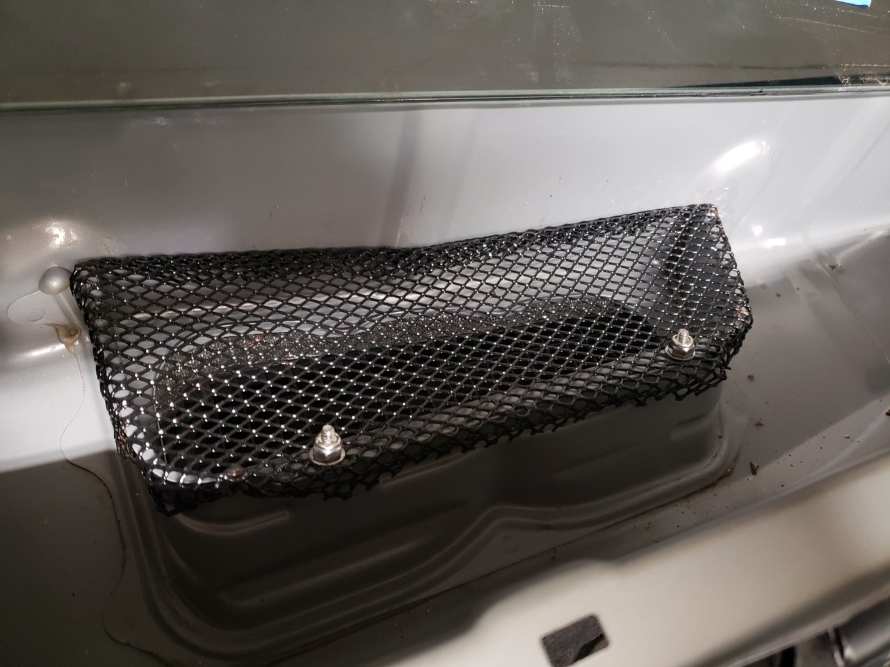

    Both metal screens purchased at Lowes.
    Engine air intake
    Cabin air intake
