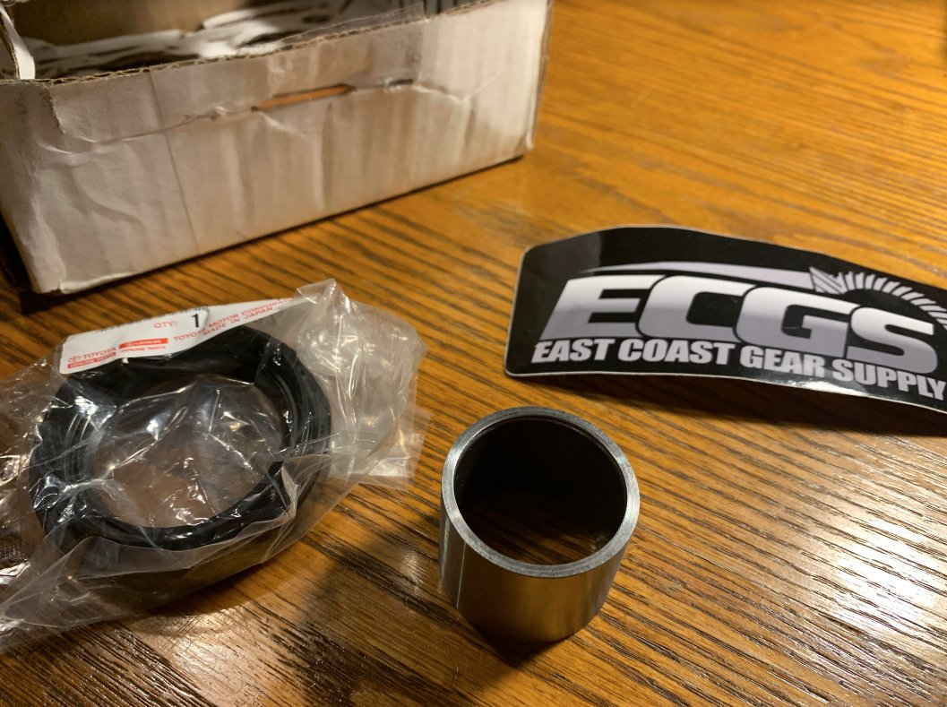

    I ordered the ECGs bushing and new seal. I'm hoping my mechanic has the needed know-how and tools available to pull the old and seat the new. That said, if anyone is in the WI area and has the puller banging around in a drawer, I'd be happy to pay shipping to borrow it for a week.

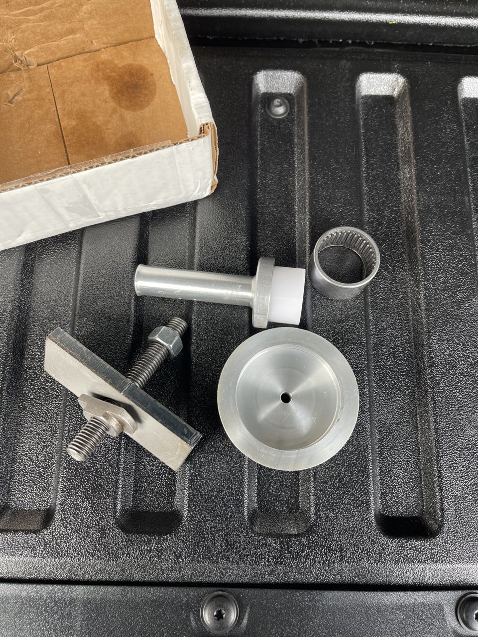

    Ok, we are rolling in the right direction. Cheers to ECGS for quick shipping!

    Hey Op I just did an ECGS install on my truck this past weekend and it wasn’t too bad of a job. Having the puller and install tool definitely helps out a lot. If your mechanic doesn’t have anything to pull the bushing out PM me and I can loan you the tool as long as you ship it back to me. I have all 3 tools puller, installer, and seal installer
