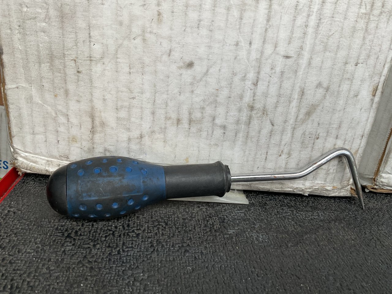

    I don’t know what they’re called, I call them hose hookers. You slip it between the hose & pipe. Chances are you won’t get those hoses off, more so if they’re super stiff, you can’t squeeze them. They might crack like a piece of stale bread.
