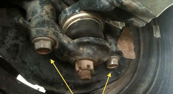

    The pics is just showing everyone the part and the bolt locations.. The bolts are out, but the spindle is the part that is stripped..

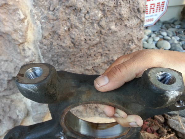

    Here is a pic of my knuckle.. As you can see, the left side is smooth for the first 1/8" or so... other side looks better, but was starting to do the same thing. A longer bolt wouldn't have worked as the stock bolt is nearly the max length for the knuckle..
    Actually I did have to locate sub bolt which was a bit longer. Toyota was backordered on the stock bolt. Needed a couple of washers to take up the space as I didn't want to cut the bolt and risk another fail...
