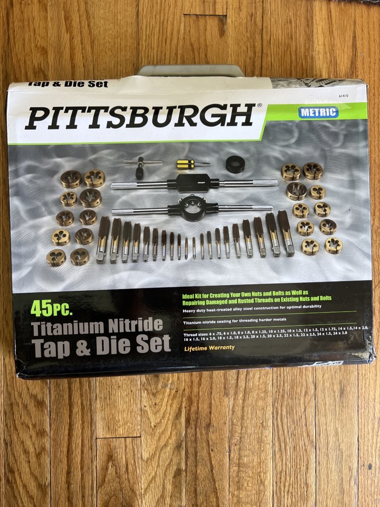

    Ditto! Honestly, hardest part was finding an M14x1.5 tap. ACE stopped carrying the Irwin Hanson one. The guy at my local called 5 stores… they had all pulled it from the shelves. Said it wasn’t selling well enough when they did an inventory re-boot.
    But, Harbor Freight had a full metric kit for $90 bucks. So I got carried away and tap and die’d all the hardware for my skid plates as well . Pretty big range of sizes too. Hopefully I save someone a wasted trip to ACE! Or at least warn them to give ACE a call first.
