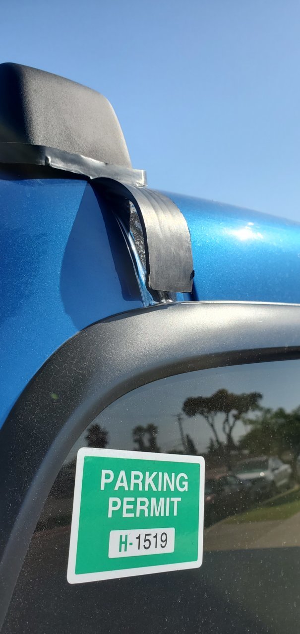

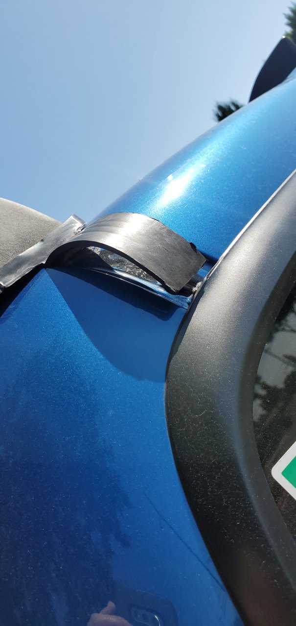

    He y'all so i just got a oem roof rack for my taco and my first problem was the weather strips in the back, it didn't even stick for 30 mins. Any recommendations on what i can use to stick the weather strips in place?

    Make sure to prep the area before hand - removing the old gunk, and cleaning the metal beneath with some alcohol to give you a good bonding surface

    I literally did this install yesterday. Doublesided gorilla tape. Done.

    Use a heat gun too soften it,then put the strip in place and tape it down with masking tape,after it cools and takes the needed shape,lift it up and use Gorilla 2 sided sticky tape,then taped it down again for about a day.
