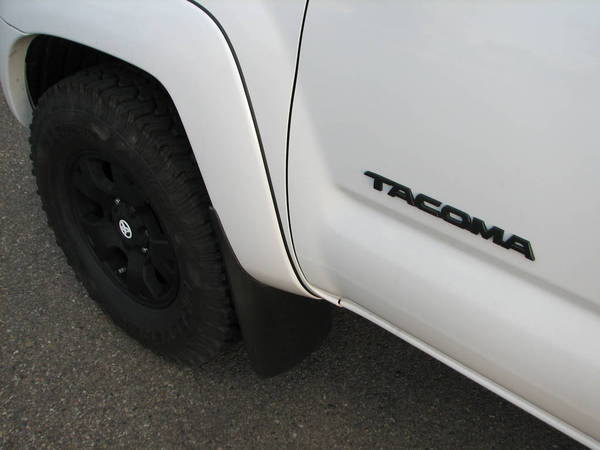

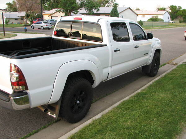

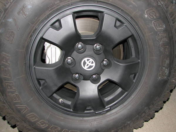

    Heres some pics of the rims on the truck... thanks again for all of your help TW!!!
    I'm looking at black lugs next... don't like the chrome.
    I have to hand it to my wife... she was real patient with me all weekend. I was pretty grumpy this morning when I realized it wasn't supposed to be fuzzy. I sure am blessed!

    Sweet! :thumbsup: Looks great, oh and nice choice of color :p

    That looks good! How exactly did your wife do the center caps?

    Thanks yotanator! Super White FTW!!
    I would like to thank everyone on TW that has commented on my wife's center caps... you are giving her a big head. I will never hear the end of this one!! haha She did do really good though, she is a much better painter than I am. She should offer her Rim/center cap painting services similar to the Satoshi and cluster services.
    We got the idea from another guy on here (sorry I forgot his name). Take off the center cap, use a dremel to cut the back of the Toyota symbol plastic welds (we didn't have a dremel so we used some wire cutters that are flat at the tip (i can take a pic tomorrow). Then a flat head screw driver to scrap the weld off and push the emblem out. Primer and spray paint the emblem white (Dupli-color gloss white--I guess it matches better than their color match) and center cap flat black. Once dry, put the two pieces back together and use Loc-tite 7 min Plastic Epoxy to glue where the plastic weld originally was on the back side.

    :eek: I didn't even try to take mine off. I just free handed the emblem with a paint touch up brush

    How did you get the Toyota emblem painted on the center cap? Did you take the emblem off?

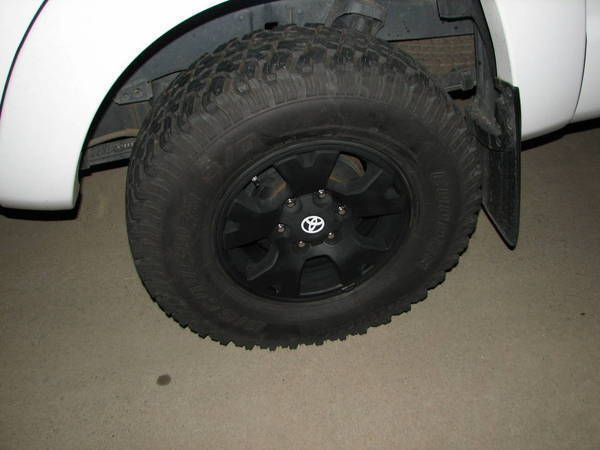

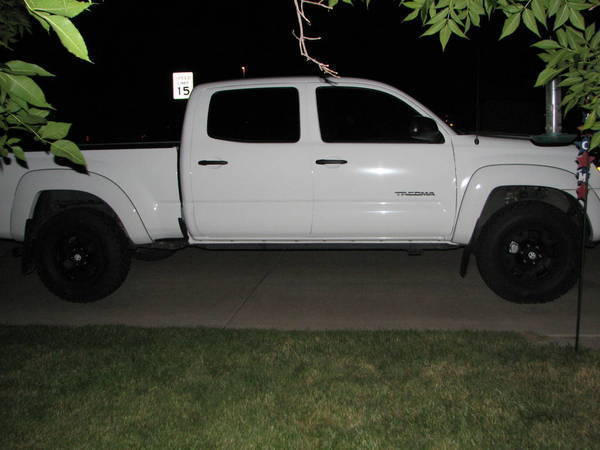

    Got some pics of the wheels in the light. Thanks again for all of your help! Couldn't have done it without your help!

    Looks really good! :thumbsup:

    Looks great!!! At least you figured out what the problem was, painting problems are a pain. Hang on to that woman, sounds like you found a winner!
