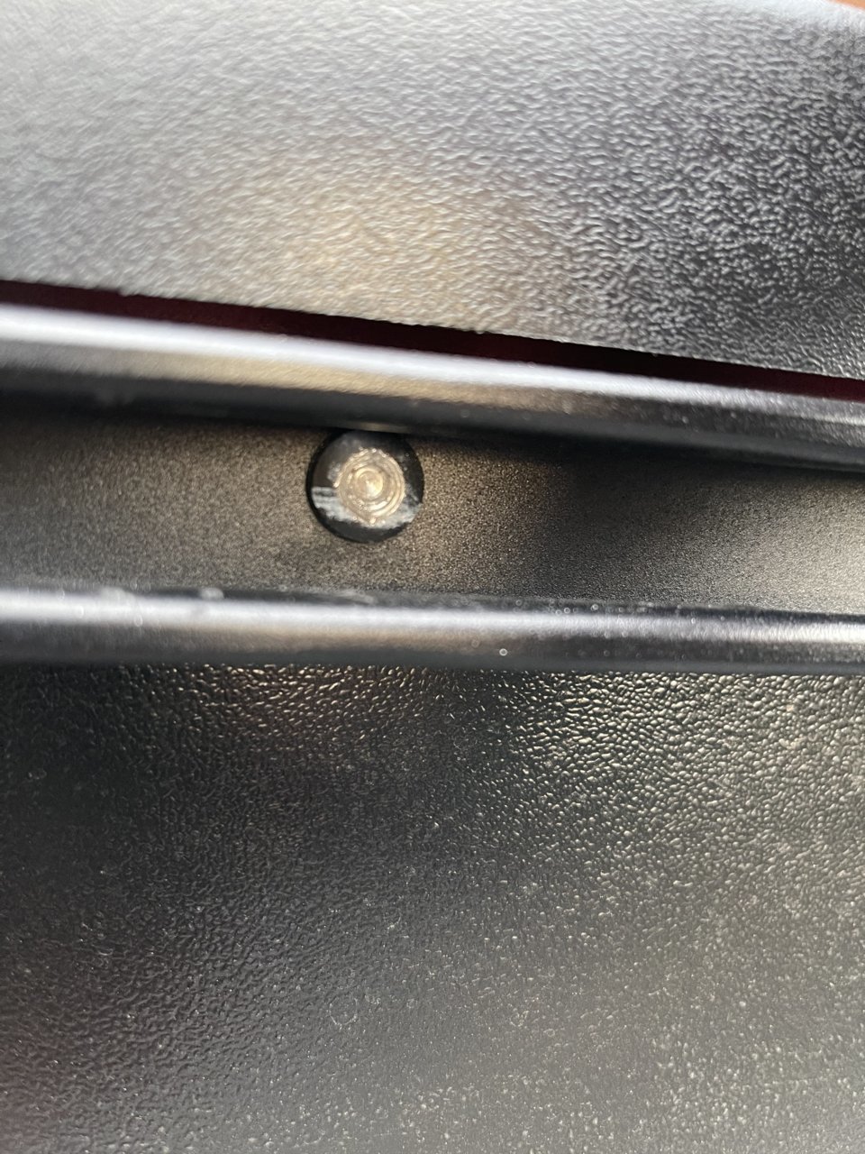

    HELP! Some of my bed rail torx screws are stripped (4 total). Can someone help me out or know a shop that will take the screws out? I’ve searched and done what others suggested. I’m about to give up installing my bakflip bed cover. Located in Tacoma, WA. Thanks in advance.

    Post a pic of the stripped heads real quick

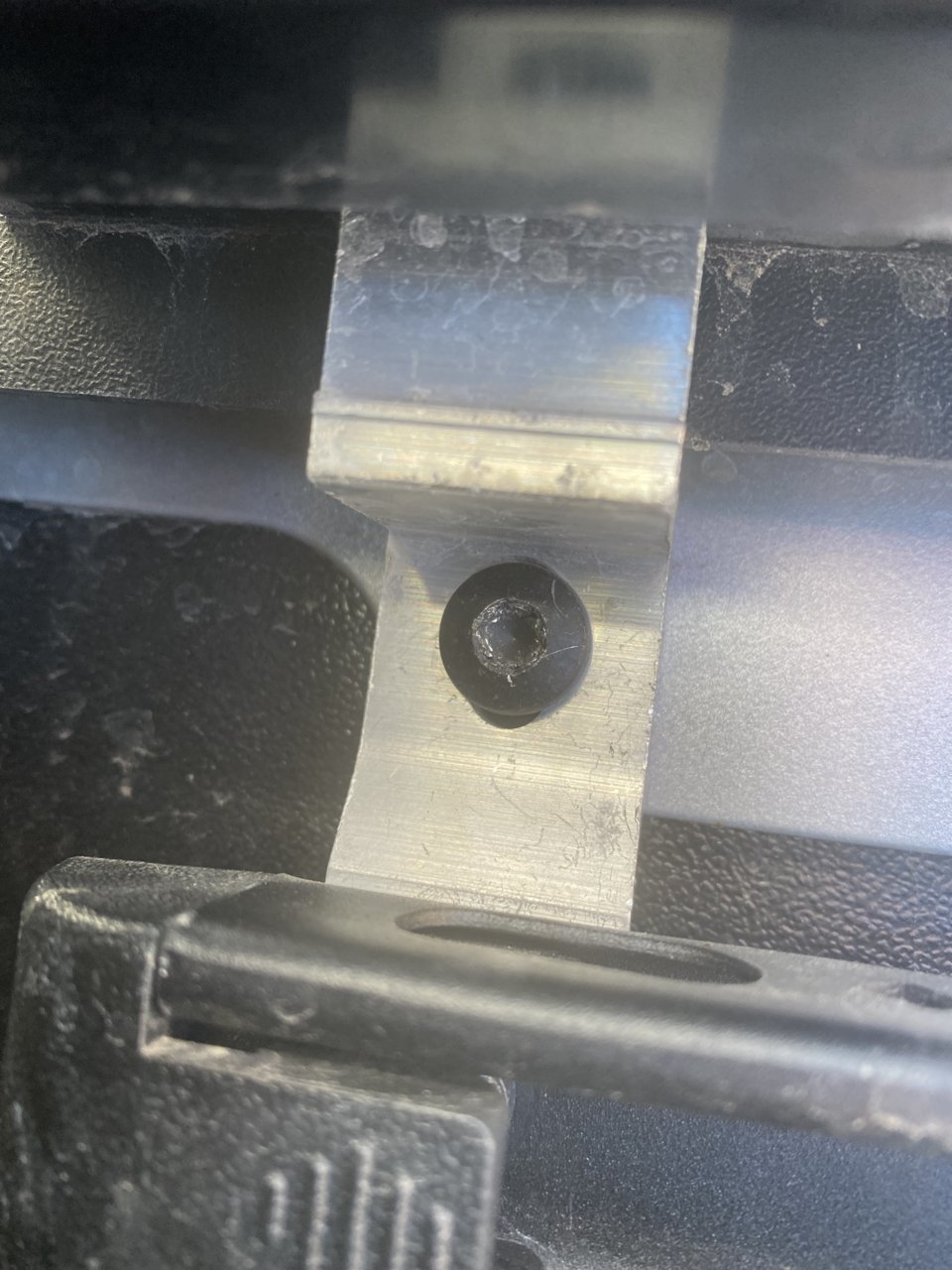

    40B68259-9745-4BE7-846E-40A752D6711D.jpg A5894403-C020-4C5C-8818-6E67DC0B7564.jpg
    They all mostly look like this. Tried different size screw extractors but no bueno.

    Might as well just drill them out. Looks like you are already nearly there from the extractors

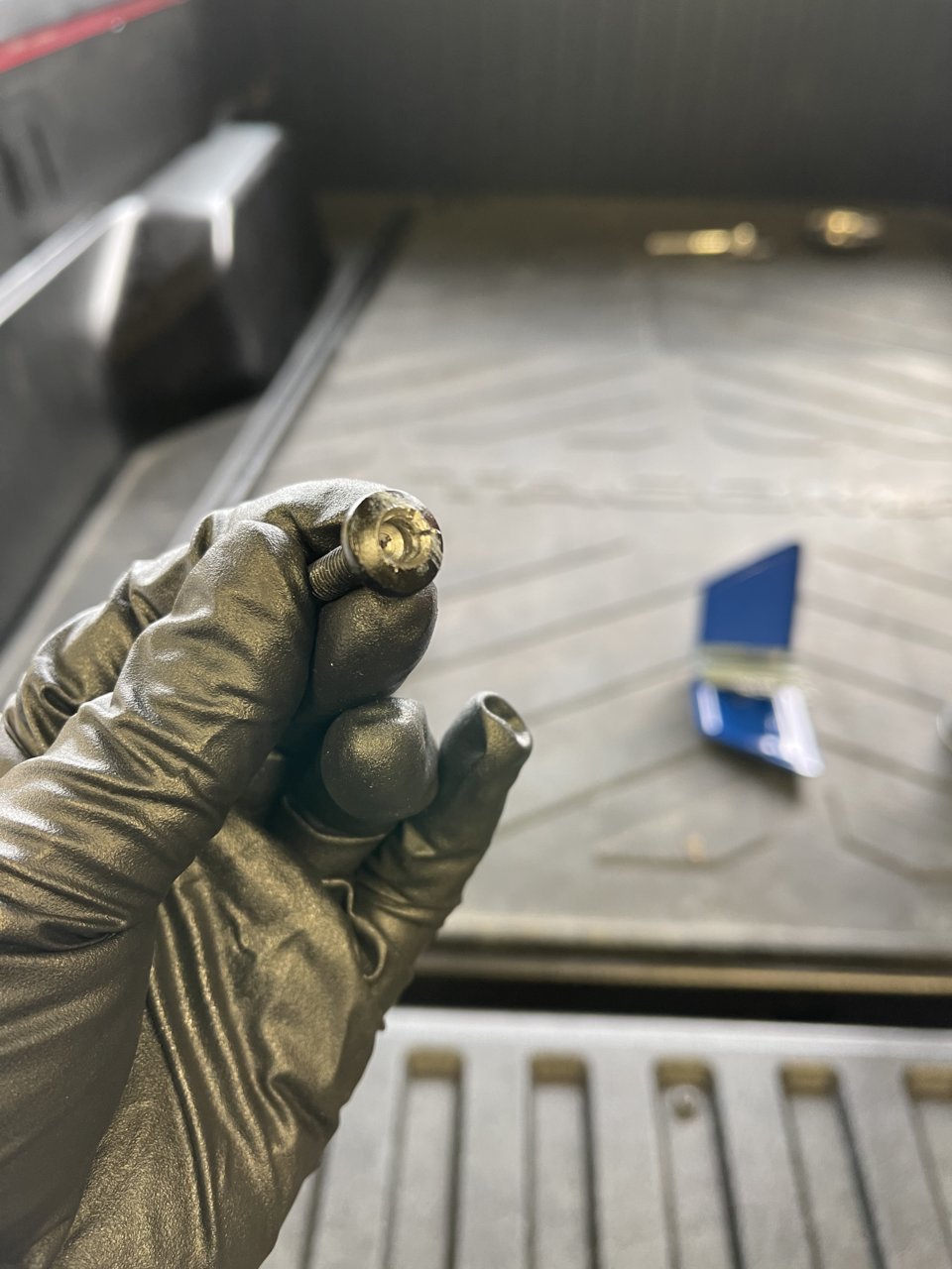

    34605E76-13E5-4FD0-81A2-3839BBF27F8C.jpg Success! Now 3 more to go.:annoyed:

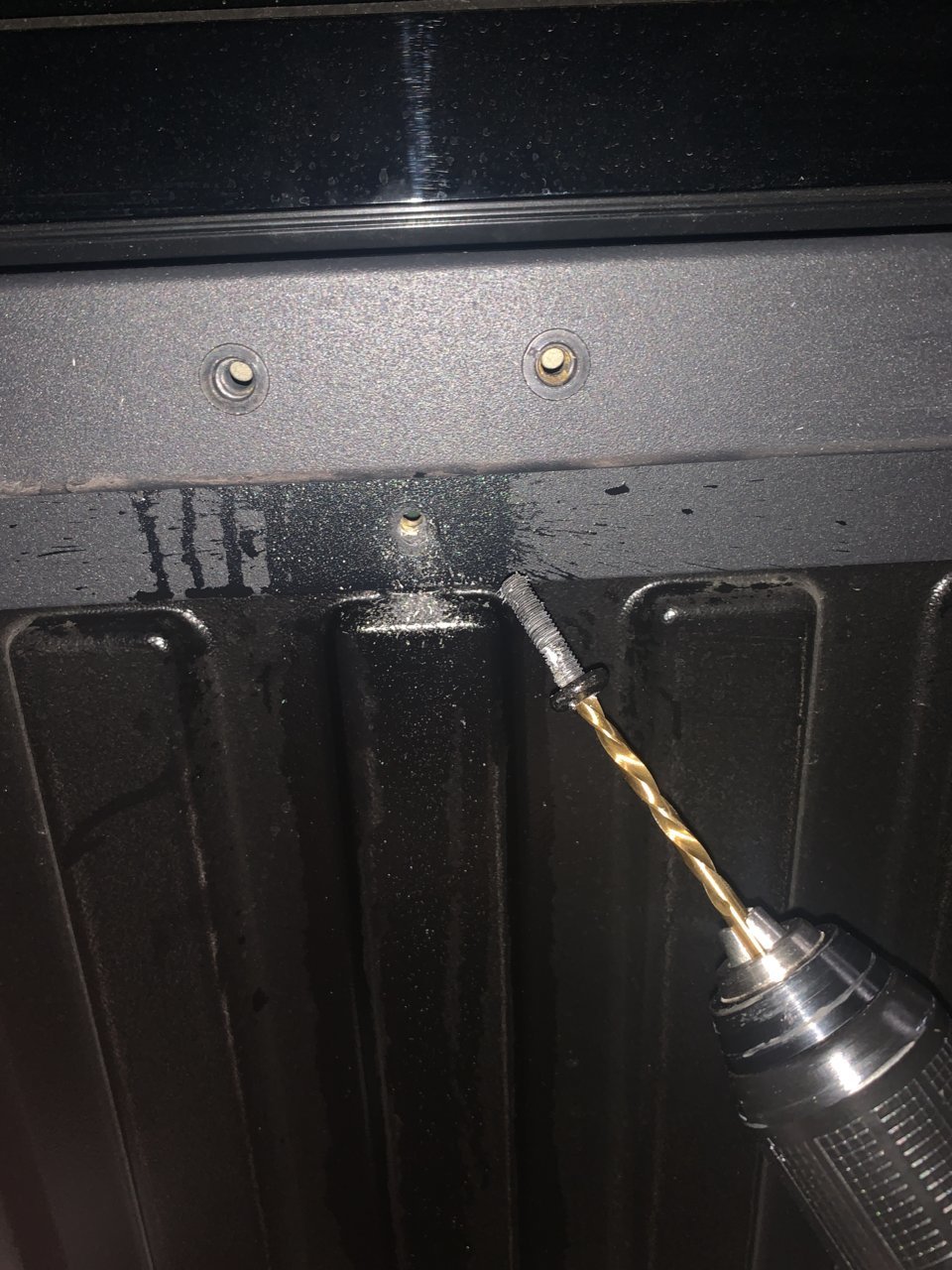

    Assuming you have a drill, buy this and make sure you’re using it correctly (watch youtube videos) - Start with the smallest drill bit and make sure you drill the center of the screw, so use a punch or nail first to mark.
    - Drill speed NEEDS TO BE LOW. Take your time.
    - Use penetrating oil if needed.
    Good luck!

    So you drill into the hole using the left handed bits, and then simply reverse out using the drill? I just stripped a bolt on mine and it’s a pain in the ass.

    Washington State
    21 DCLB TRD OR
    OEM+
    You use the left hand drill bit to extract the bolt out. It does take a lot of time since I started with the smallest and went up a bit each screw. Patience is key and don’t force the bit otherwise you’ll end up snapping it.
