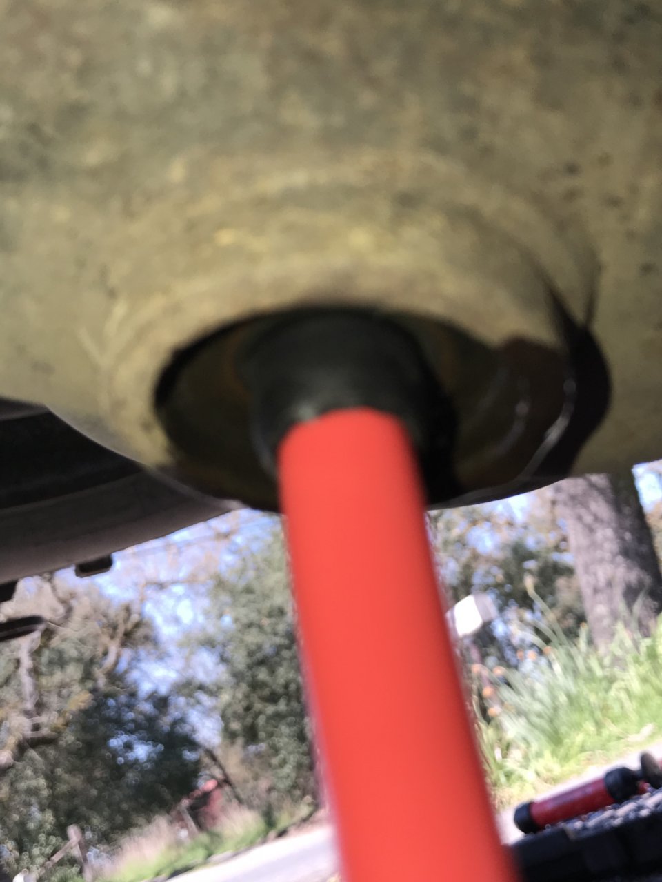

    Tdog2.7L
    Tdog2.7L [OP] Well-Known Member
    Oct 24, 2017
    #234029
    171
    2004 Tacoma 2.7l 4x4 & 2018 TRD Sport M/T
    Moment of truth

  9. Mar 18, 2019 at 12:38 PM
    #29
    95tojo
    95tojo Well-Known Member
    Mar 21, 2008
    #5421
    1,071
    Jared
    So IL
    '19 Cement Grey TRD Sport 4x4 6MT
    Actually the newer outboards do lol
    OP, wonder how this will work with the pressure building up. Guess we will see how well your dif breather works :rofl:

    That was my thought :D. Other option would be remove the third member , turn it so the drain plug is on the same level as the fill plug originally was and fill it. You will have perfect fluid level. A bit more work than fixing the fill plug, but the same result.

    Tdog2.7L
    Oct 24, 2017
    #234029
    171
    well that didn’t go as planned. Refer to Jimbo’s picture above^

    Damn, I was pulling for you dude. Could you maybe remove the vent plug and fill from there? Would be slow going and I am not sure if there is a baffle in there or anything. Just a thought.

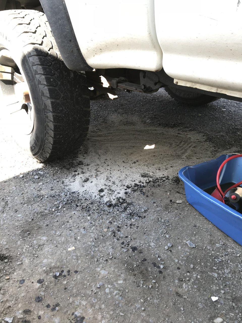

    Tdog2.7L
    Oct 24, 2017
    #234029
    171
    As soon is I removed the grommet that shit shot out so fast. Landlord is not going to be happy

  19. Mar 18, 2019 at 1:30 PM
