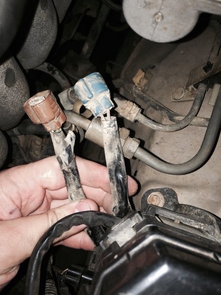

    Mosderek
    Mosderek [OP] Well-Known Member
    Mar 2, 2016
    #179965
    103
    Derek
    1995 regular cab Tacoma 2wd
    No, refer to my initial post :facepalm:
  16. Mar 27, 2016 at 11:34 AM
    #36
    Mosderek
    Mar 2, 2016
    #179965
    103
    Derek
    Can anyone verify what these plugs are for? Come out from under the fuse box. I assumed something for a/c
  17. Mar 27, 2016 at 4:42 PM
    #37
    Mosderek
    Mar 2, 2016
    #179965
    103
    Derek
    Anyone???
