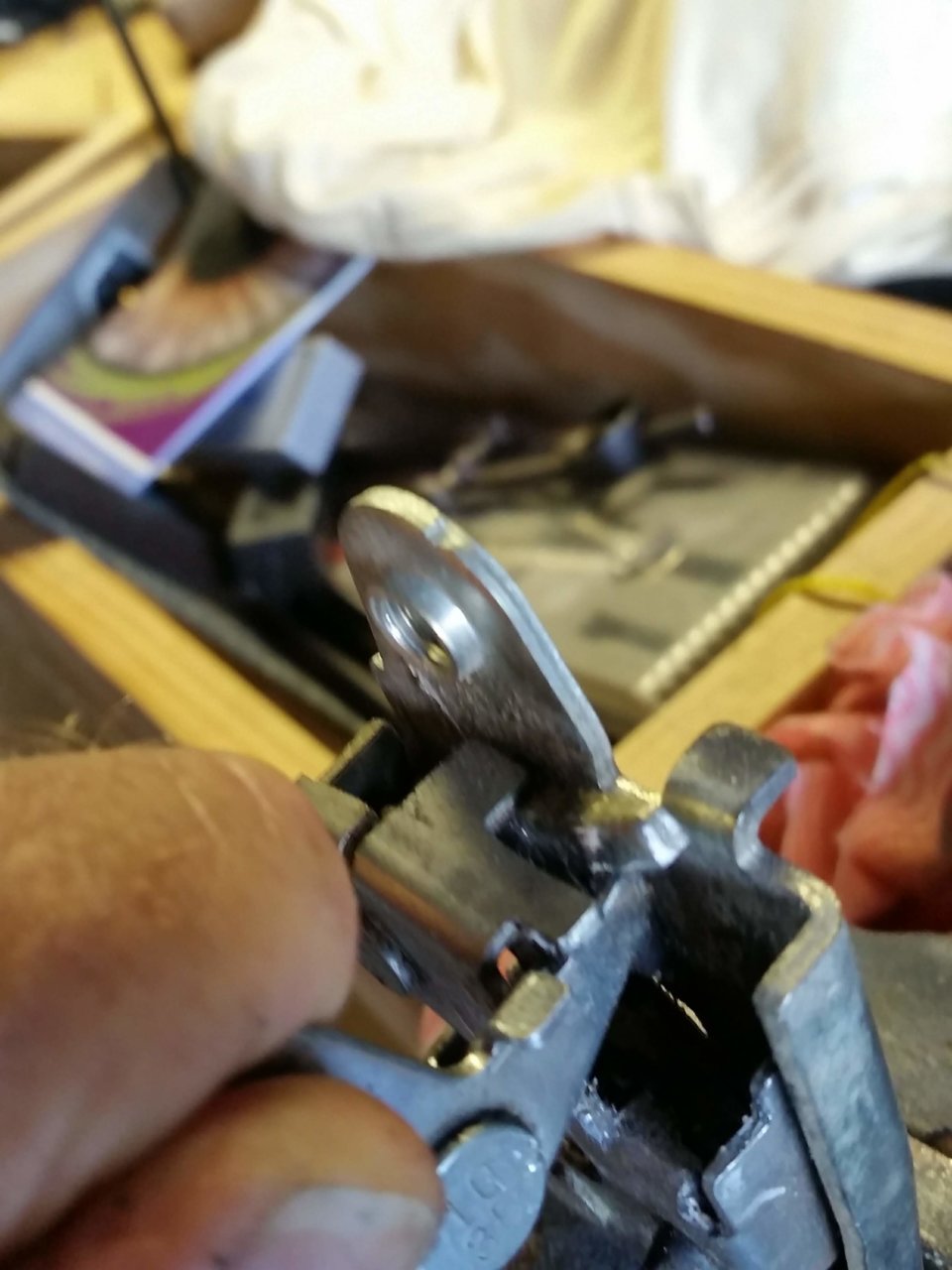

    RedRX8 Thank you for this post. Honestly I didn't understand it until I fixed it on my own tailgate but it does make sense. I couldn't figure out if the drivers side or passengers side had anything to do with it but I don't think it does. Mine happened to be on the drivers side also and after I had hauled dirt and gravel. I was able to take the plastic off of the tailgate even though the latch was stuck and the tailgate was closed. I bent the plastic just enough to slide it out of the passenger side and wiggle it free from the tailgate. I had a clear view of the lever and had no idea why it was stuck. There were no rocks in the way and it looked normal. Here is where RedRX8 had it right: When you pull the tailgate handle it pulls the rod that pushes one bracket up and that bracket pushes another bracket up also that releases the mechanism and the tailgate opens. In my case that first bracket moved upward it missed when it got pushed up and instead of pushing the second bracket, the first bracket got stuck on top of the second bracket. Now when I pulled the handle the first bracket moved up but it was on top of the second bracket so it couldn't push anything up. Now that the second bracket was below the first I took a screw driver from the inside of the tailgate (since I took the plastic cover off the top and back) and forced the second bracket up past the first bracket allowing the first bracket to fall back down. Now when i pulled on the handle bracket one pushed up on bracket two and released the tailgate. In the process I broke the little orange clip that holds the rod in place to pull lever one. I bent the rod slightly into a U rather than the L that it was in and it works great. I knew the orange clip probably wasn't sold on it's own. I hope this long explanation helps someone down the road. I didn't get a picture and couldn't find one online, all the pictures were from the outside of the tailgate and not inside behind the plastic cover.

    Photo on left is lever out of position, right is corrected.
