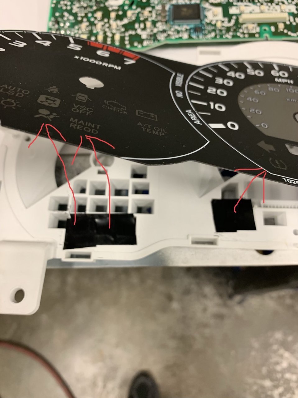

    As long as it still runs well just use this custom mod that the dealership used on my truck... Electrical tape is cheap.
    whatstcp and wilcam47 like this.

    I was joking, but if the CEL bothers you that much it's your truck :D
