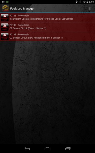

    Everything just came in today. Today I also got around to cleaning the throttle body, doing the deck plate mod, and I replaced the PCV valve. Changing spark plugs and running Seafoam (sorry other poster, I already bought it) either tonight or tomorrow.
    Alright here are my fault codes, and remember, I just replaced both O2 sensors. They were non-Denso but they were 4-pin like they're supposed to be:

    Get denso sensors...at least bank one. The one before the cats. Factory parts is all I use.
    It looks like your running way too rich.

    Looks like you need a coolant temp sensor.

    Ok, going to look into coolant temp sensor since all it is is a glorified thermistor ($0.50 a pop on ebay) to see if I can clean it off or something before ordering. Bought all the fluids I need to replace, just need to wait for a cloudy day to do it. I found a Service Repair Manual for the '99-'00 models and it's freaking awesome, so I'm going to test the leads on the O2 before sending it back. Unfortunately RockAuto will not give me my money back, only facilitate a replacement with the manufacturer [Ultra-Power], and I'm not throwing 40 bucks out the window if I can help it, so buying a new Denso after getting this one a couple weeks ago will be the very last thing I do.
    - Fuel filter was kind of a bitch going in - was afraid I would strip the threads since my pipe is bent at an angle. The old one was super nasty; it turned the drained gas a mud color.
    - What's funny now is that I and a few respondents have thought I might be running rich, and after driving with the deckplate out, I have a new error about it running too lean, but the others codes remain after a clear.
    - Got a torque wrench - figured I should do things as correctly as possible.
    - Also tightened my gas pedal to throttle cable, but that's unrelated to anything in the thread. I wish I could make it as sensitive as modern cars....
