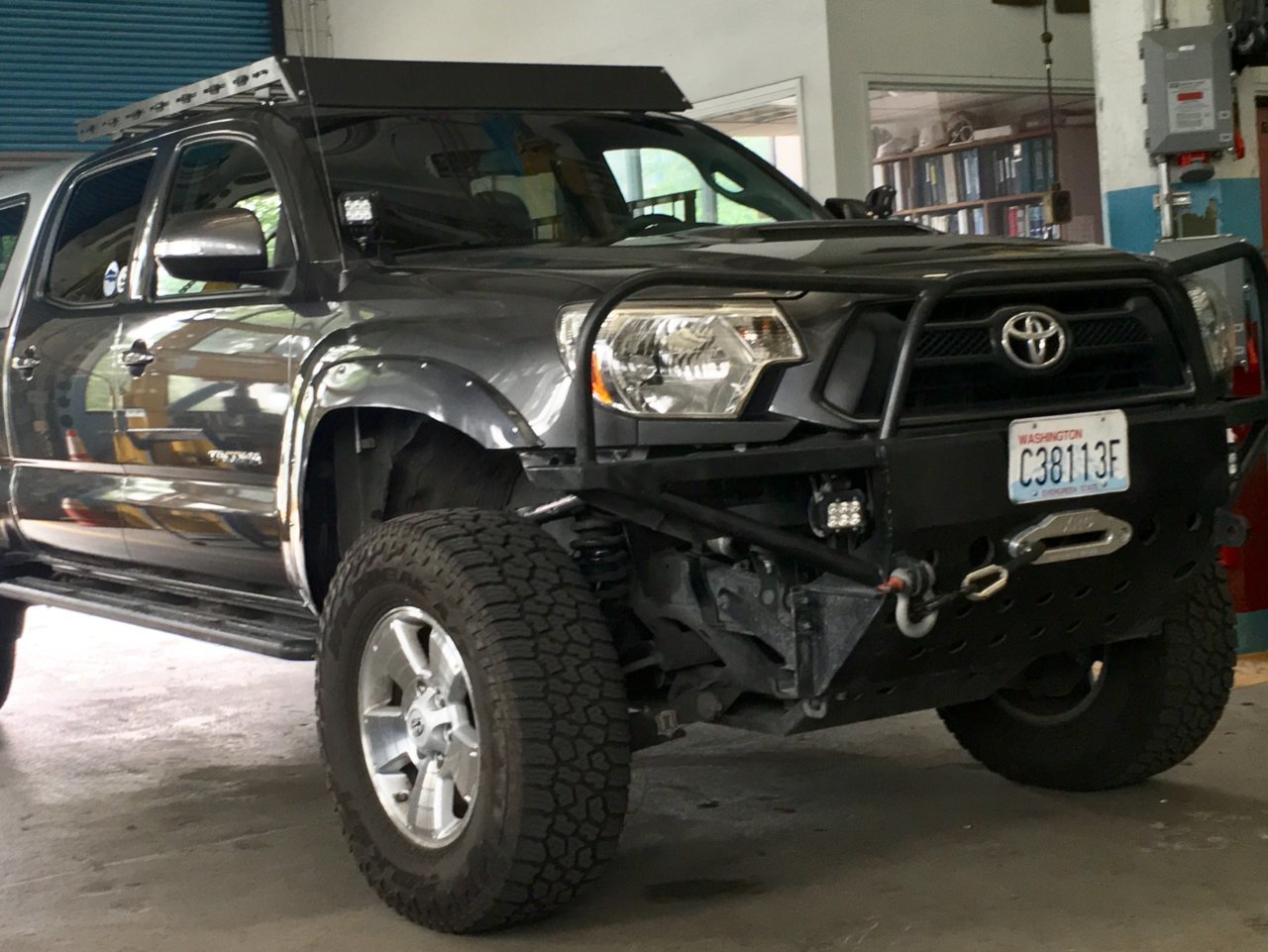

  13. Jun 30, 2018 at 11:39 AM
    Juforrest
    Juforrest Dumb!
    Nov 23, 2015
    #170434
    5,937
    Justin
    Seattle
    Reformed Taco driver in a GX460
    I average 15mpg combined. IMG_0736.jpgSomething is a miss in your truck. Check your math, tire pressure, plugs, brakes etc.....
