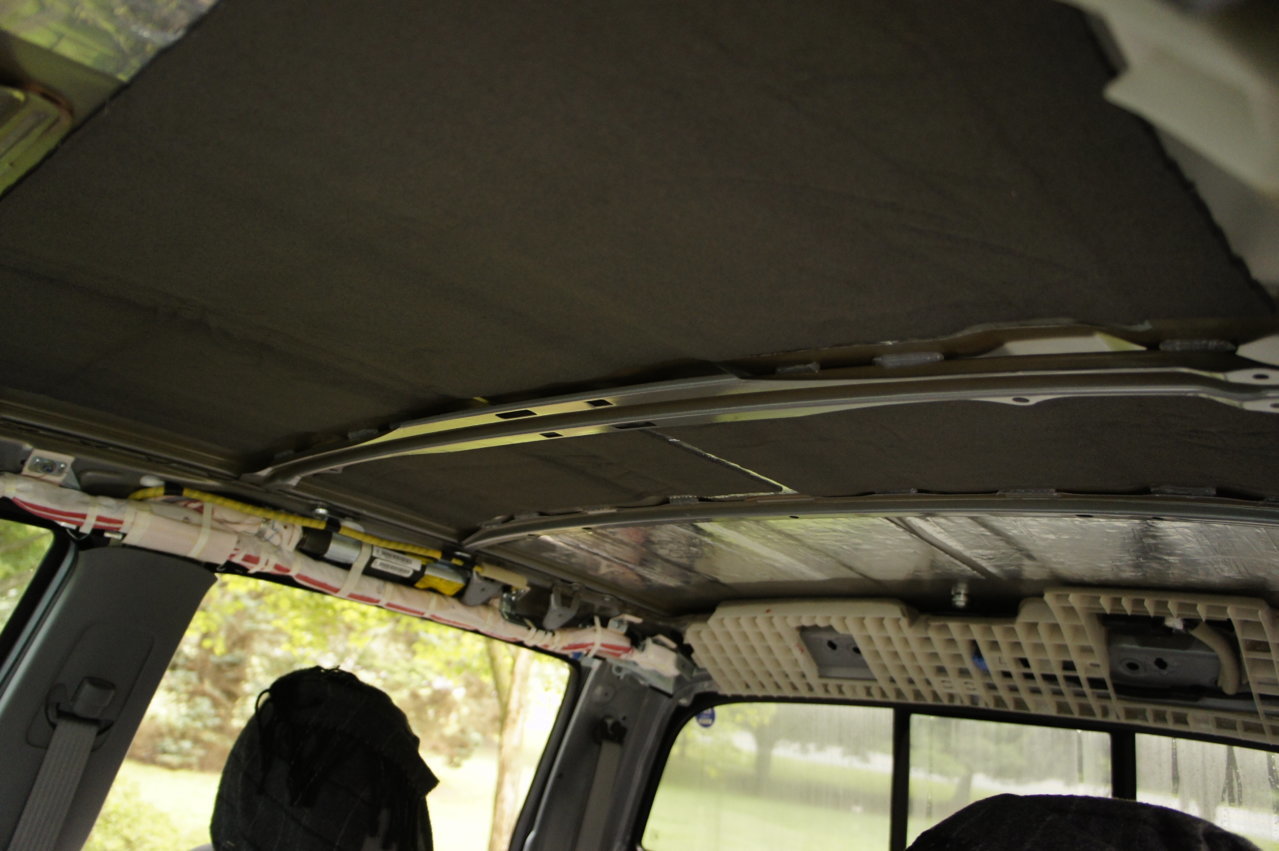

    On a 2nd gen you have a fair amount of work to pull down the headliner. It was 5-6 years ago. I had to remove the clothes hooks, I think they twist off. The hand holds, bolt on. Some of the rear pillar trim may have to be removed. You should then be able to get your hand under there.
    Best rear window picture I have.

    Yeah it looks like not a very fun process. I think I'm going to need to get the headliner down to around the dome light or so to be comfortable to get myself behind it, and not bend it. This truck has like 7,000 miles on it and I don't want to mess up expensive interior parts..yet.

    As rnish said, it's a lot of work. To do it without headliner damage. Pull c- pillar panels, b- pillar panels, at the minimum to drop it enough. To get at brake light bolts. Warning if you damage it new headliner is $1500

    Yeah thats what I figured. Take off the coat hanger hooks in the back, take off the plastic behind the handle to get to the bolts to pull those off, the dome light cover, then the B and C pillar covers that meet up to the headliner... I'm sure there is something else also.. Just to be able to drop that thing in the back a good 24" or so without folding it. Since I have the sunroof I'm sure that would be as far forward as I can go in terms of dropping just the back of the headliner.

    Drop the headliner down, and while you are in there, put some sound deading mat on the roof. You will thank me later.
