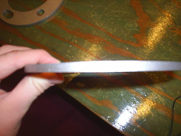

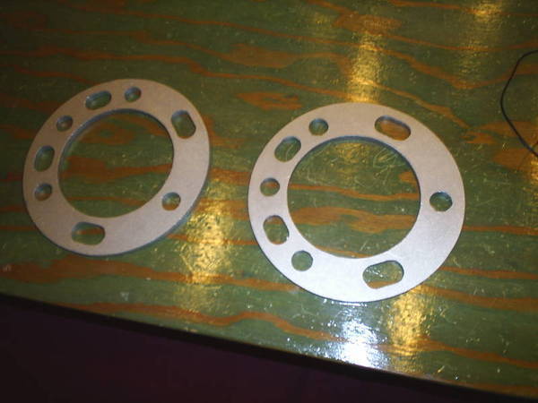

    Heres some pics of the wheel spacers

    uh...are you gonna make your own holes because i dont count 6 of them......

    Its a "universal" spacer. There are 6 holes, just a couple of them are oblong.

    ahhhh, i see said the blind man.
    curious any issues when installing those, taking some thread away from the stud and lug nuts???

    They should be used with longer lug nuts.

    I have the same problem with my truck. Its lifted 2 1/2 inches and I'm running 285/75/16 BFG Mud Terrains on stock rims. The rub the frame on a tight turn. I put 1/4" spacers just like yours but they threw th wheels of balance so bad that I took them back out. At 60 my truck shook bad.

    Put the wheel spacers on and no more frame rub and it wasnt too hard installing them. I drove it around to make sure there were no wheel vibrations or other weird things and it seems fine.

    I too re-installed my spacers after having my tires re-balanced. Good news is no vibration. It wasn't the spacers. Now I'm happy with no rub or vibration.
