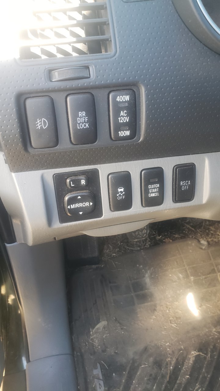

    Here's the default layout for a manual transmission truck, automatics have the DAC button where the Clutch Start Cancel is on manuals.
    What are you trying to find the connector to?

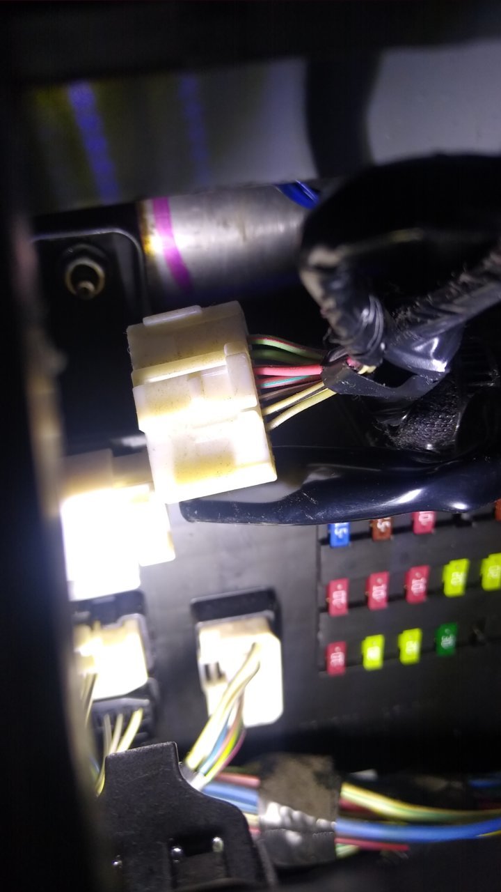

    Well, I have the base access cab and was looking to see what plugs are behind the blanks, and I found this square, four prong white plug. Mostly curious about that one at the moment.

    What color are the wires going to it?
    Post a picture of it and the wires.

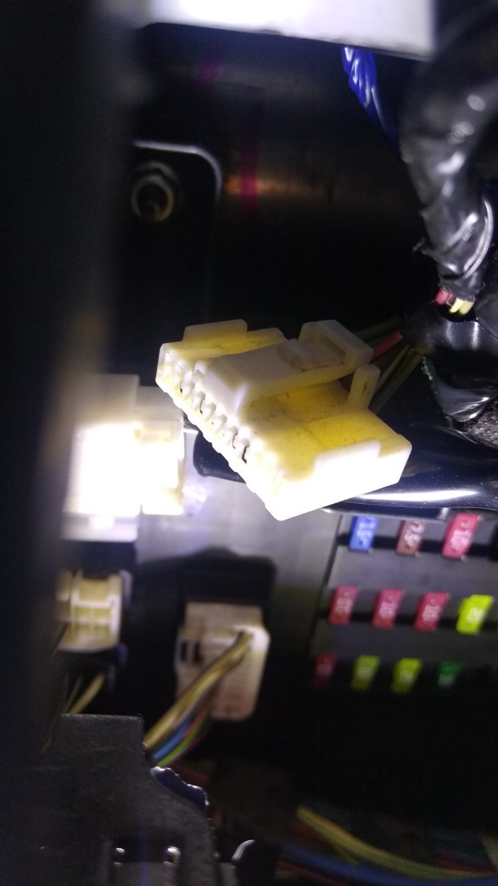

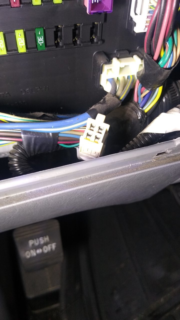

    The wires are grey, black, red and blue.
    Also found this other plug ....IMG_20221110_180141023.jpg IMG_20221110_180239574.jpg IMG_20221110_180255083.jpg

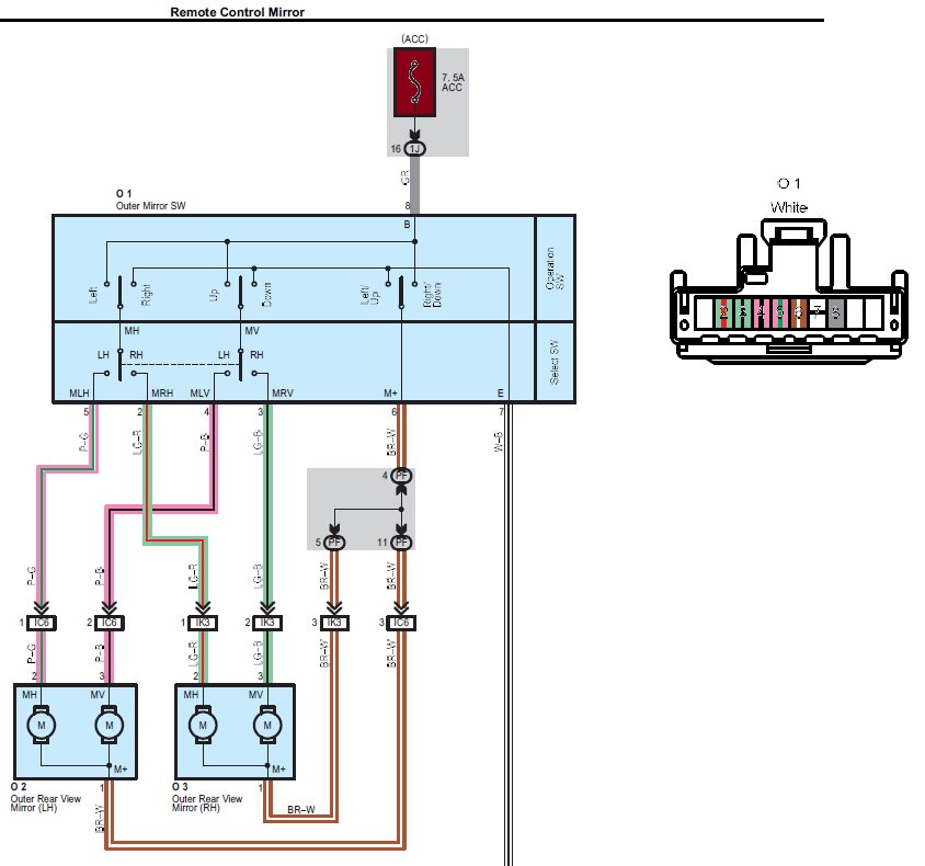

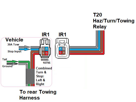

    Looking at my truck the 4 pin plug is one half of a junction connector although I haven't yet determined what goes through it.
    Looks like the flat connector is for the power mirror switch, wire colors are Green/Pink, Green/Black, Pink/Black, Pink/Blue, Brown/White, White/Black, and Grey.

    Just be aware that although you may have some connectors for a particular option the truck may not be fully wired for that option.
    Found the 4 pin plug, it is junction connector IR1 which is part of the towing package wiring.

    Hood Struts, My version Fogs always ON, Map & Overhead Light Mod,
    Remote Control connector to Door mirrors
