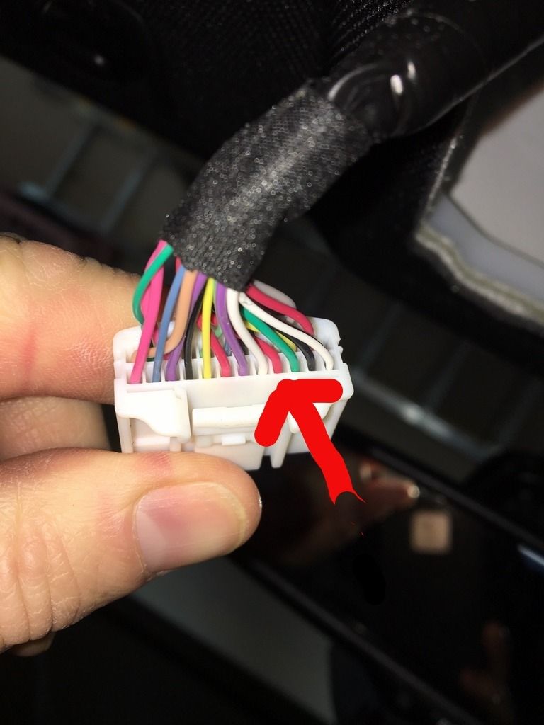

    IMG_0160.jpg [​IMG]
    So I hit the main harness connection powering the entire console with a test light. The bottom red wire (4th from the last in the pic) is hot on accessory. So if you look at the picture it's the red wire on the bottom between the white and green.

    78
    South Central Texas
    2016 Silver SR5, V6, 2WD, AT, DC, SB w/Tow
    Thanks!
    Is the black wire (2nd from right in the pix) ground?

    Confirmed. Red wire is constant/always on 12v. For ground just tap the metal behind the console. Now I can have my blue lights for EMT/Fire without having to rip out the trucks panels.
