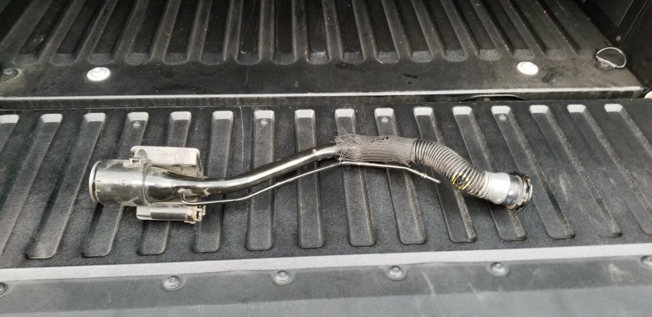

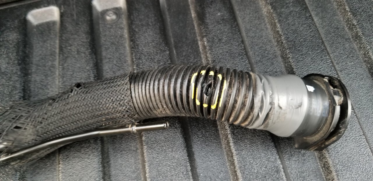

    So what ended up happening was that when I had my tonneau cover installed a week ago they had to enlarge the drain holes in the bed, and they must have nicked the fill hose when they did that. The dealership dropped my gas tank expecting to find rodent damage to the hose, but they found artificial damage from a drill bit. The tonneau cover installer has agreed to cover the damages, which is good because it cost $583 to replace the hose! Be cautious when drilling these holes out guys, the gas fill hose is somewhere very near the driver side drain hole. Thanks for all the help and time in figuring this out you guys.

    Here's a photo of the hose and the hole. $104 dollars for the hose alone. I was expecting rubber hose and some hose clamps haha

    Yeah, I'm pleased all around with the help I got resolving the issue. It took the dealership a few days to get the part, but that couldn't be helped. Be careful using step bits as well on this, that is what the installer used and still nicked it. It is very very close to the drain hole
