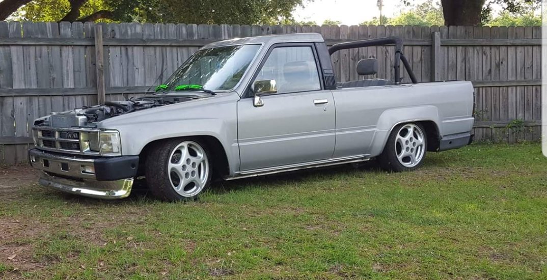

    The trans is in my 88 4runner ...this is an old pic when I had a tundra v8 in it ...now it has the 06 4cyl with 40k miles
