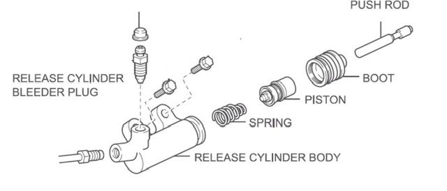

    No one asked but in case you wondered what is inside the slave cylinder
